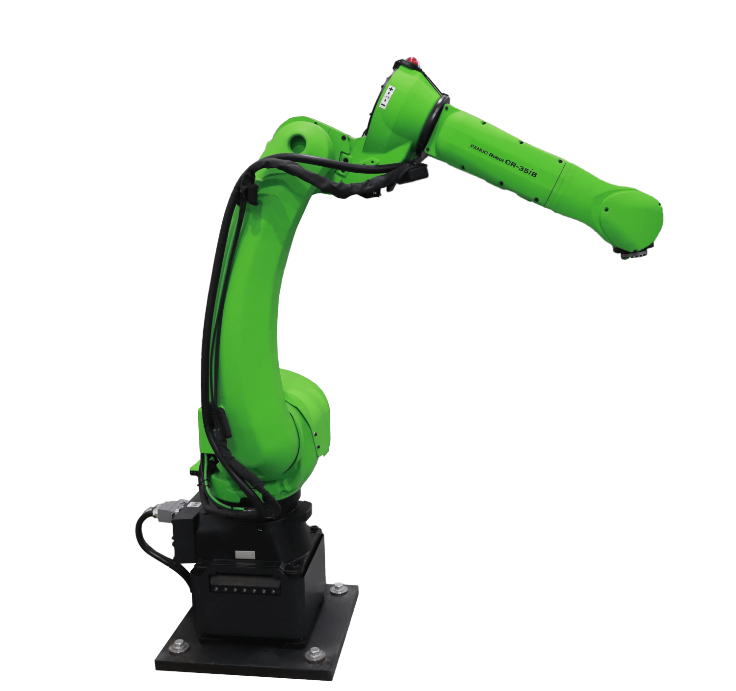

Meet the CR-35iB cobot, the industry's strongest cobot with a payload of 35kg or 50kg, capable of working alongside operators in various applications that typically require lift-assist devices or custom equipment.
Despite not being part of the CRX series, the CR-35iB features a large work envelope and a small installation footprint, making it ideal for some of the same tight spaces that the rest of the CRX line would work well within. This lighter, streamlined mechanical unit integrates FANUC's newest safety sensor technology while retaining the simple programming synonymous with the CRX series.
50 kg
1643 mm
375 kg
General Specifications
Controller R-30iB Plus
Max Payload 50 kg
Reach 1643 mm
Axes 6
Mechanical Weight 375
Repeatability ± 0.03
Mounting Method floor
Motion Range
J1 Motion Range 370°
J2 Motion Range 215°
J3 Motion Range 338°
J4 Motion Range 400°
J4 Motion Range 280°
J6 Motion Range 900°
Maximum Speed*
Collaborative Mode 750 mm/sec
High Speed Mode 750 mm/sec
*Please set motion speed according to risk assessment of system.
Allowable Wrist Load*
J4 Moment/Inertia 110/4
J5 Moment/Inertia 110/4
J6 Moment/Inertia 60/1.5
*Nm/Kg.m²

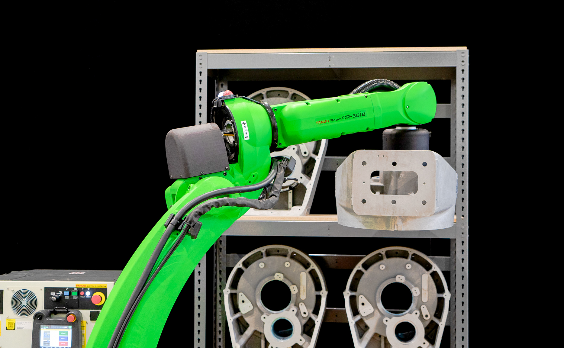

FANUC’s CR-35iB is the industry’s strongest collaborative robot. It features a payload of up to 50kg, a large work envelope, and a small installation footprint, making it suitable for small spaces.
Footprint
Object recognition ready
Depending on your needs, the CR-35iB can be equipped with a FANUC Vision Sensor or a FANUC 3D Area Sensor, enabling it to locate or visualize products.
Fast
Easy to program
The CR-35iB doesn’t need special programming or complicated languages. Operators can program with the FANUC Hand Guidance option, or use FANUC’s tablet TP, which features a ” drag-and-drop” user interface.
More range of motion
A larger range of motion means even more flexibility and dexterity for various applications, including vision-guided picking or inspection, material handling, part transfer, machine tending, packing, palletizing, and more. Also, a hollow arm design minimizes interference with peripheral equipment. Whatever the task, if it has a heavy payload that also requires close interaction with workers, the CR-35iB is a great fit.
