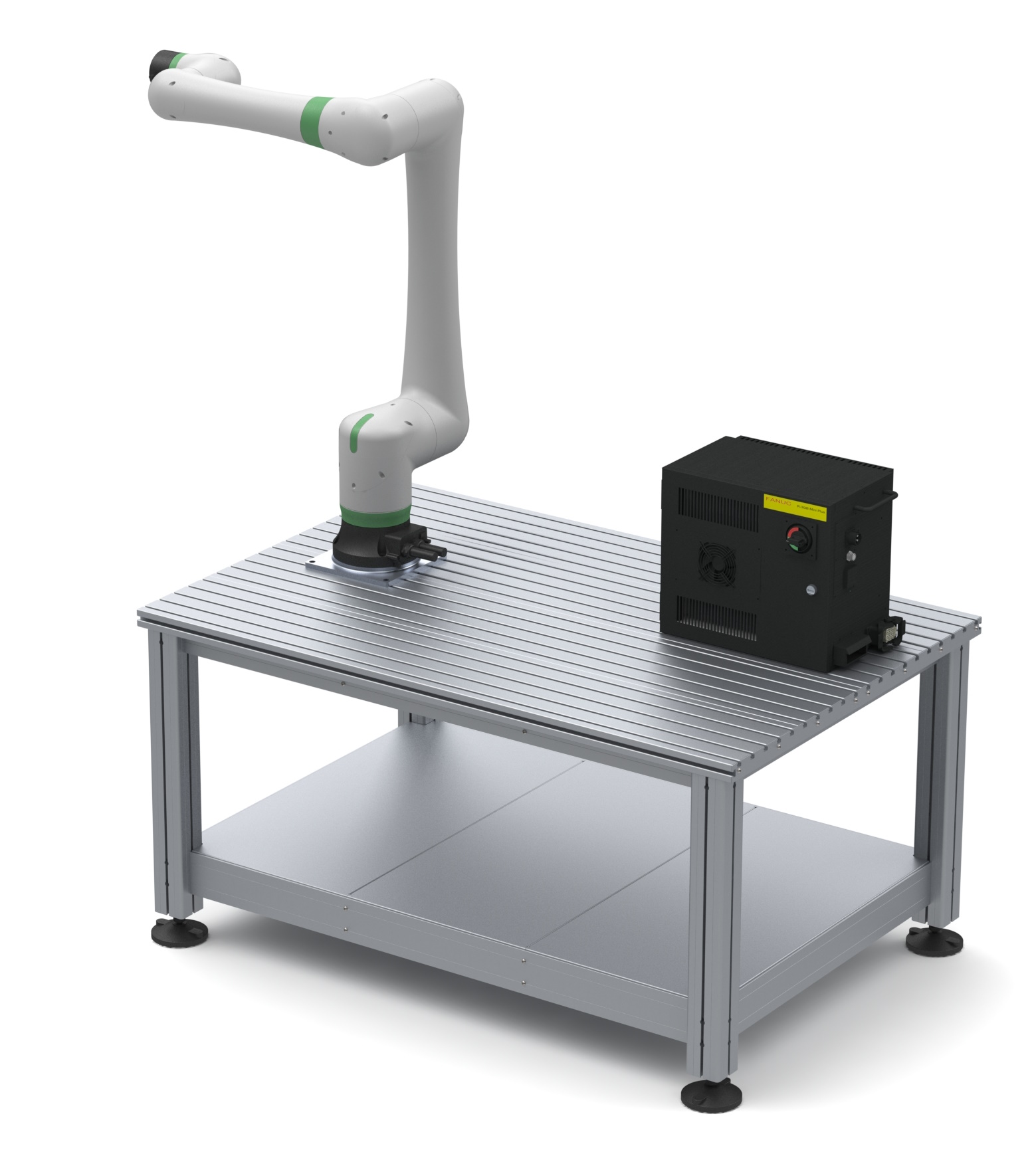

CRX-10iA

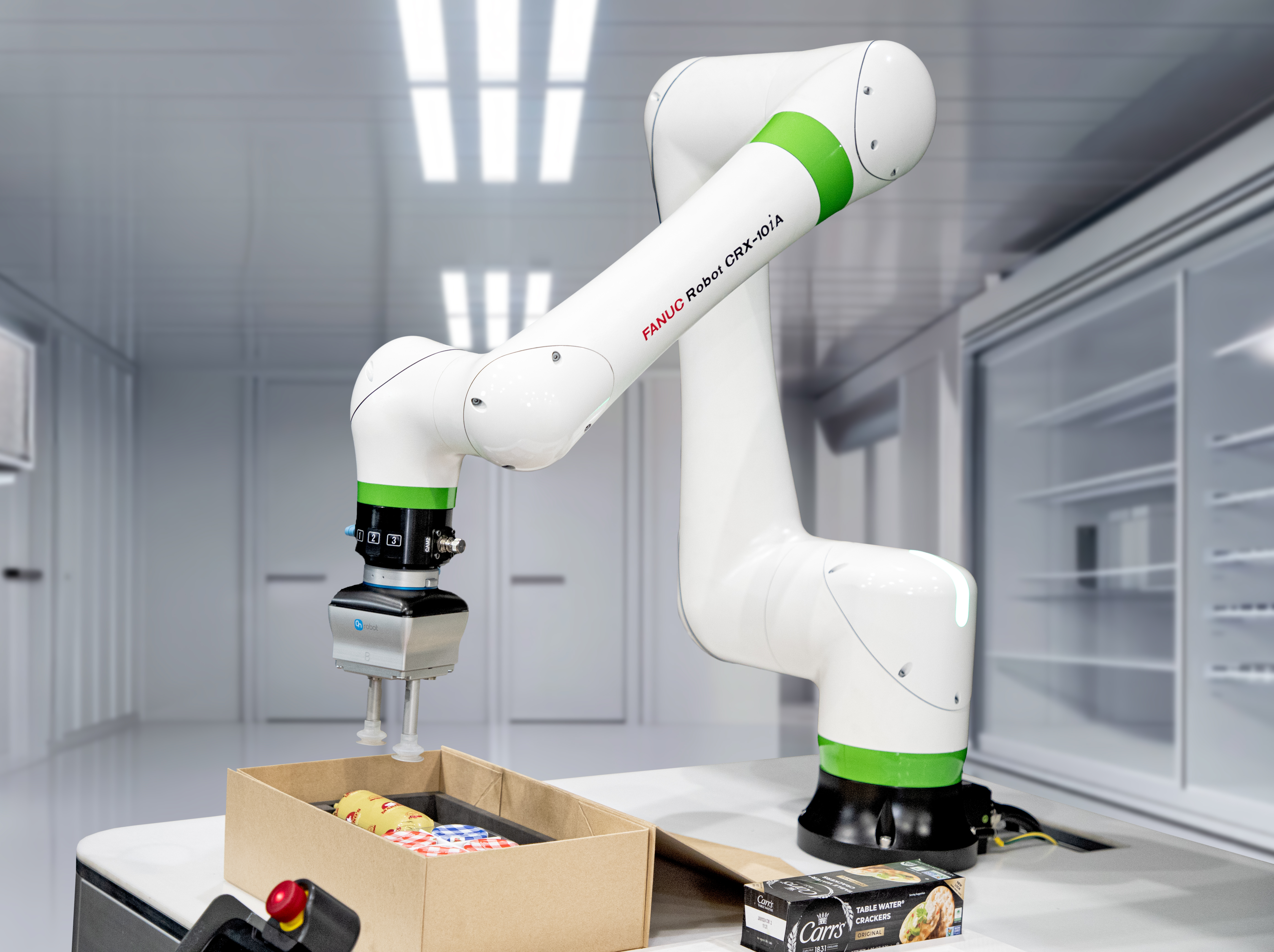

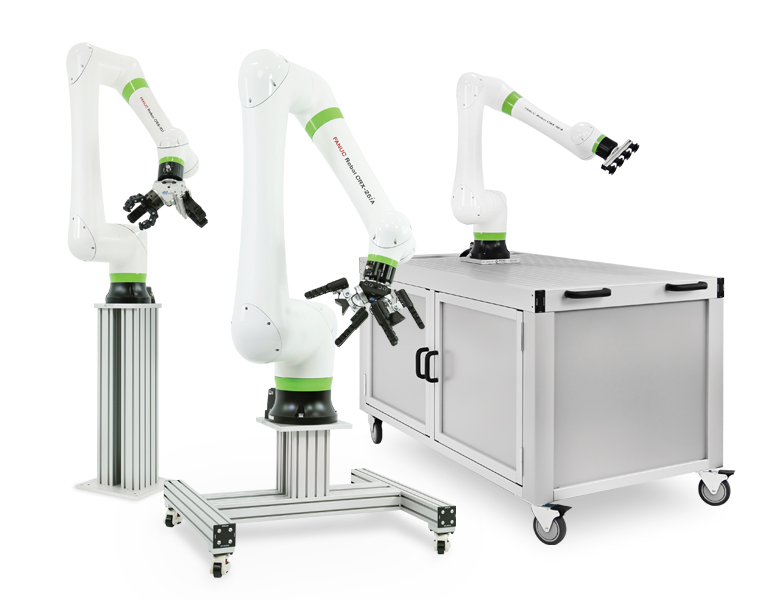

The CRX-10iA cobot is a great option for manufacturers new to robotics. It has a 10kg payload capacity and a 1249mm reach, making it a suitable solution for various tasks.
The CRX series offers an all-new FANUC programming interface with simple drag-and-drop technology on a touchscreen teach pendant, making it a great choice for applications like palletizing, welding and assembly. The ease of programming paired with FANUC’s world-renowned technology, proven reliability, and sensitive contact detection allows the CRX-10iA to work safely alongside people in various industrial and manufacturing jobs.

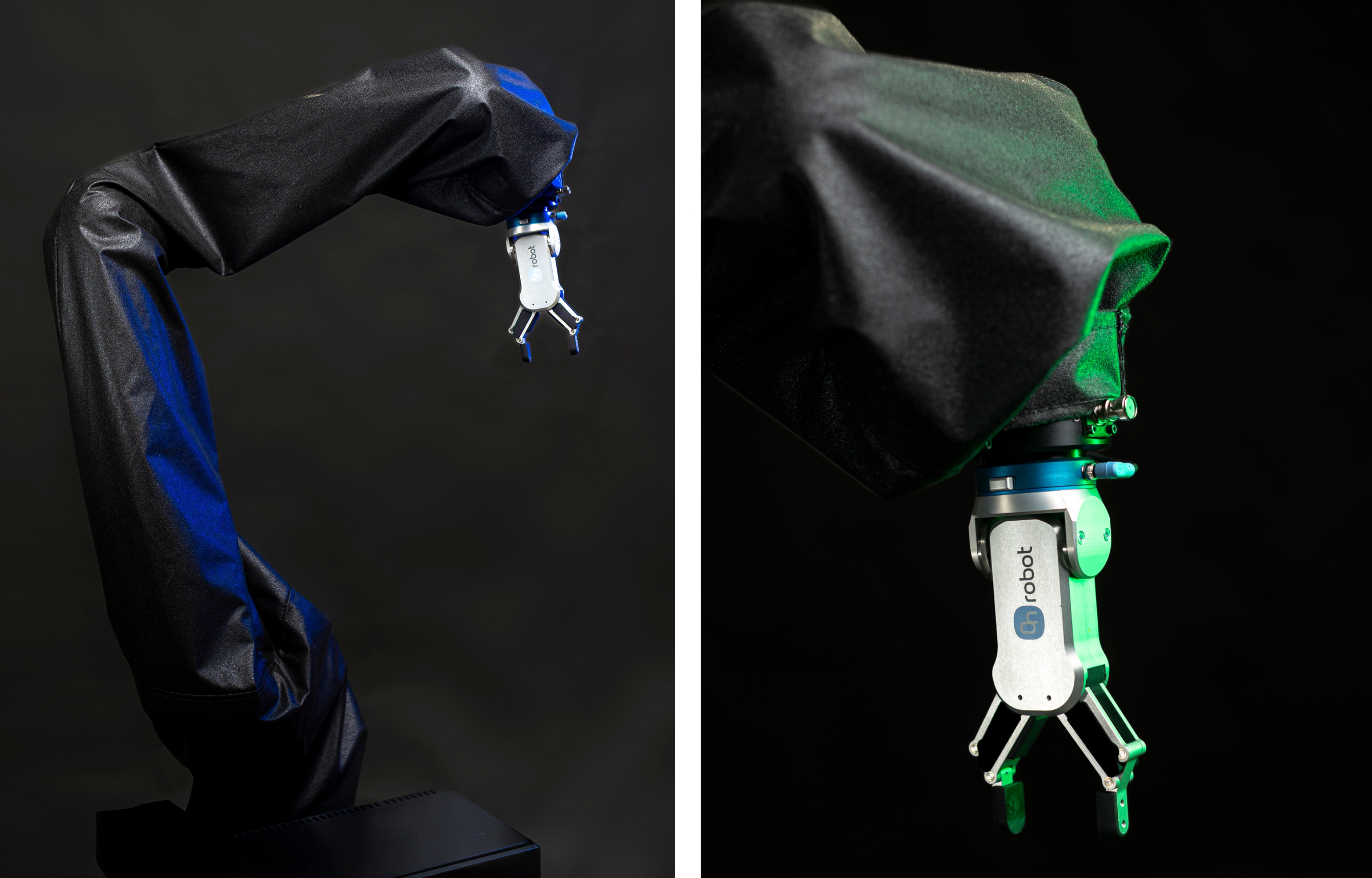

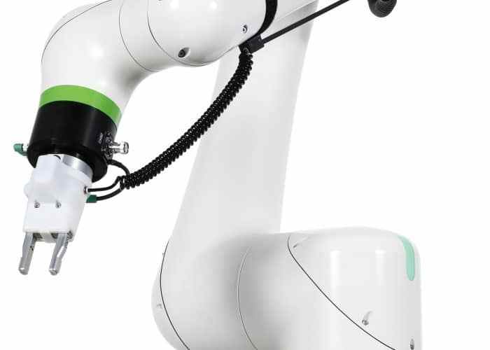

The CRX series of Cobots is 8 Years Zero Maintenance with the proven industrial reliability FANUC customers expect. For applications where sanitation is an absolute must, the CRX-10iA is also offered in a food-grade cobot model.
10 kg
1249 mm
40 kg
General Specifications
Controller R-30iB Plus
Max Payload 10 kg
Reach 1249 mm
Axes 6
Mechanical Weight 40
Repeatability ± 0.04
Mounting Method floor, angle, inverted
Motion Range
J1 Motion Range 380°
J2 Motion Range 360°
J3 Motion Range 570°
J4 Motion Range 380°
J5 Motion Range 360°
J6 Motion Range 450°
Maximum Speed*
High Speed Mode 2000 mm/sec
*During short distance, it may not reach the maximum value stated. Please set motion speed according to risk assessment of system.
Allowable Wrist Load*
J4 Moment/Inertia 34.8/1.28
J5 Moment/Inertia 26/0.9
J6 Moment/Inertia 11/0.3
*Nm/Kg.m²
Input power source (VAC)
Power Source 100-120
Power Source 200-240
Protection
Body standard IP67
Wrist & J3 Arm IP67
Download Specs

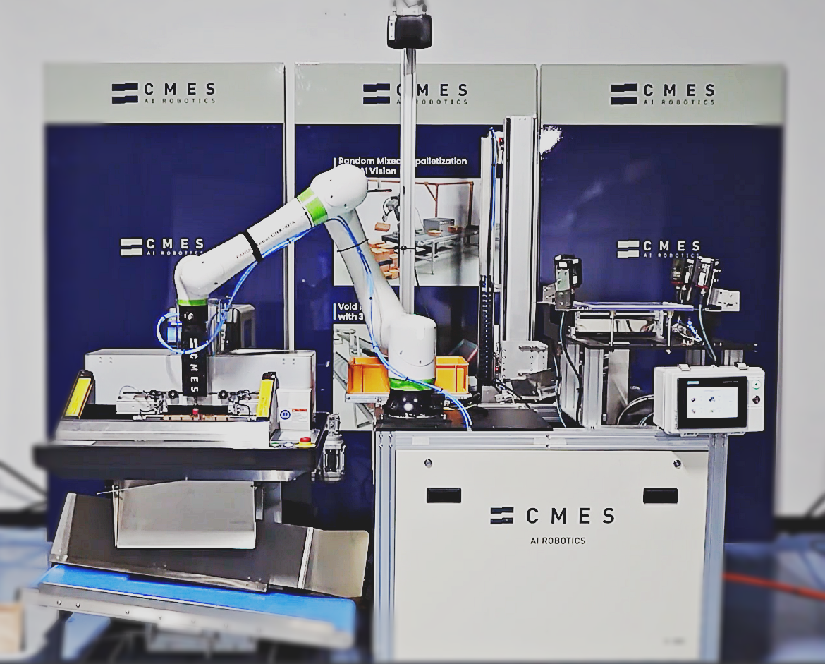

Piece Picking and Bagging CRX Hero Image wepb
CMES Robotics
Automated Robotic Bagging Solution
CMES Robotics' Automated Robotic Bagging solution delivers true end-of-line automation for piece picking and order fulfillment. By combining CMES's AI-powered 3D vision, a collaborative robot arm, and PAC Machinery's automatic bagging system, the cell perceives, picks, places, packs, and preps for ship in one continuous flow. Why operators choose it:Sustainable by default. Recyclable paper bagging replaces plastic poly mailers with no loss in speed.Seamless WMS integration. Plugs into existing fulfillment workflows. No process rebuild required. Accurate verification. Built-in barcode scanning validates every pick, even from mixed-SKU bins. Labor leverage. One operator can oversee multiple stations, redirecting headcount to higher-value work. Built for high-mix e-commerce fulfillment, 3PLs, and operations scaling order volume while cutting plastic packaging.

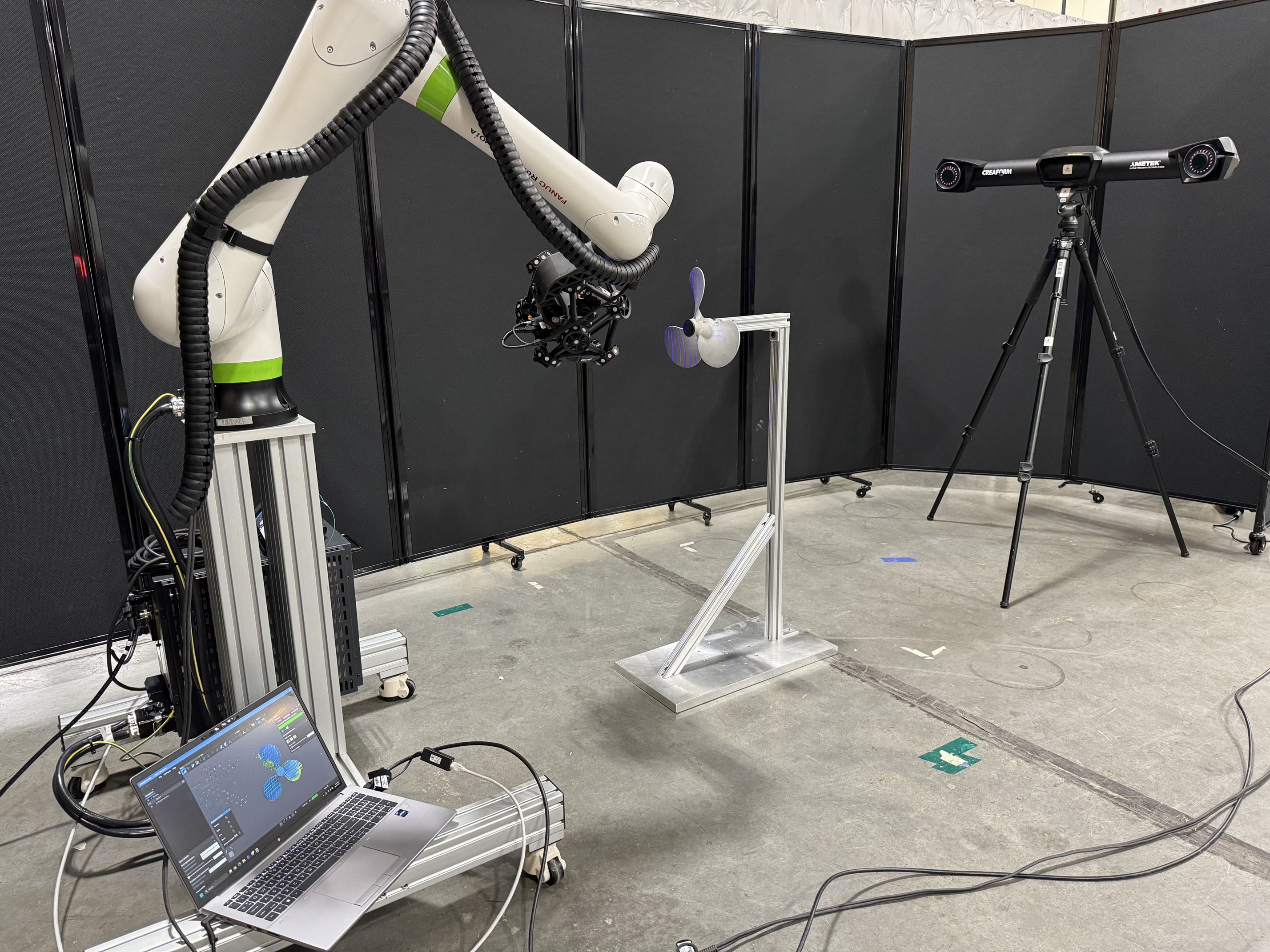

ATT Metrology Solutions Automated Inspection System
ATT Metrology Systems
The ATT Automated Inspection System is a fully integrated, pre-configured robotic cell designed to deliver high-accuracy, repeatable 3D scanning and dimensional inspection on the factory floor.
