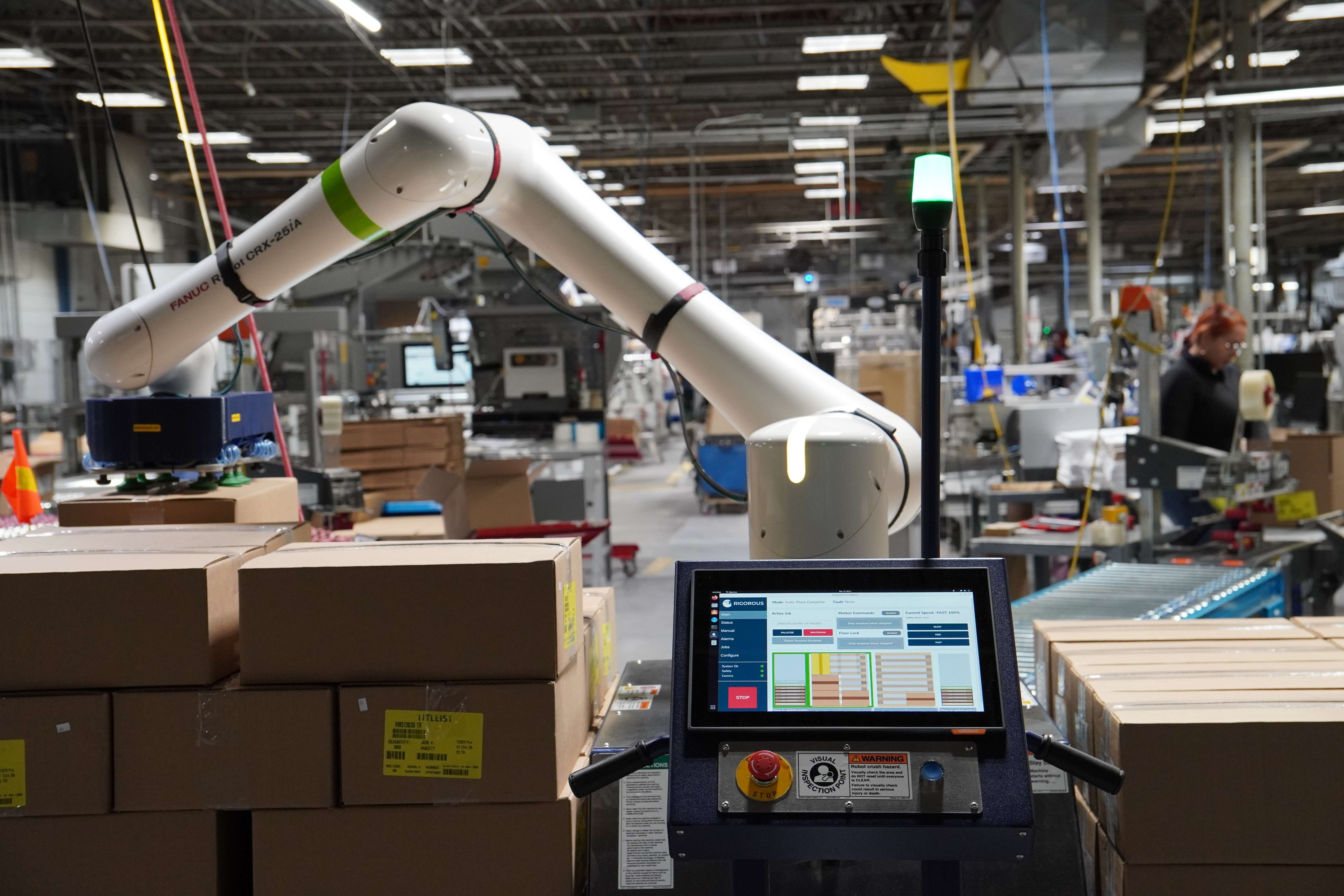

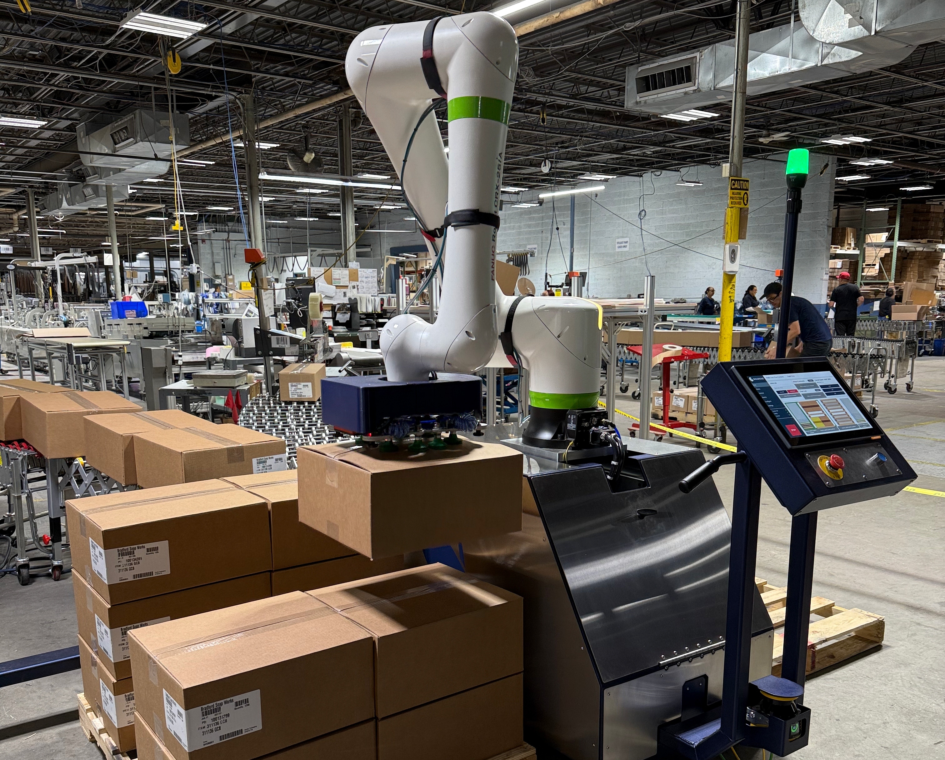

  • Vision-Guided Picking, Fault Detection & Resolution
  • Ships Fully Assembled
  • Touchscreen HMI
  • Unlimited SKU Configurations for High-Mix
  • Mobile with Embedded Safety
  • Remote Access to Data & Analytics

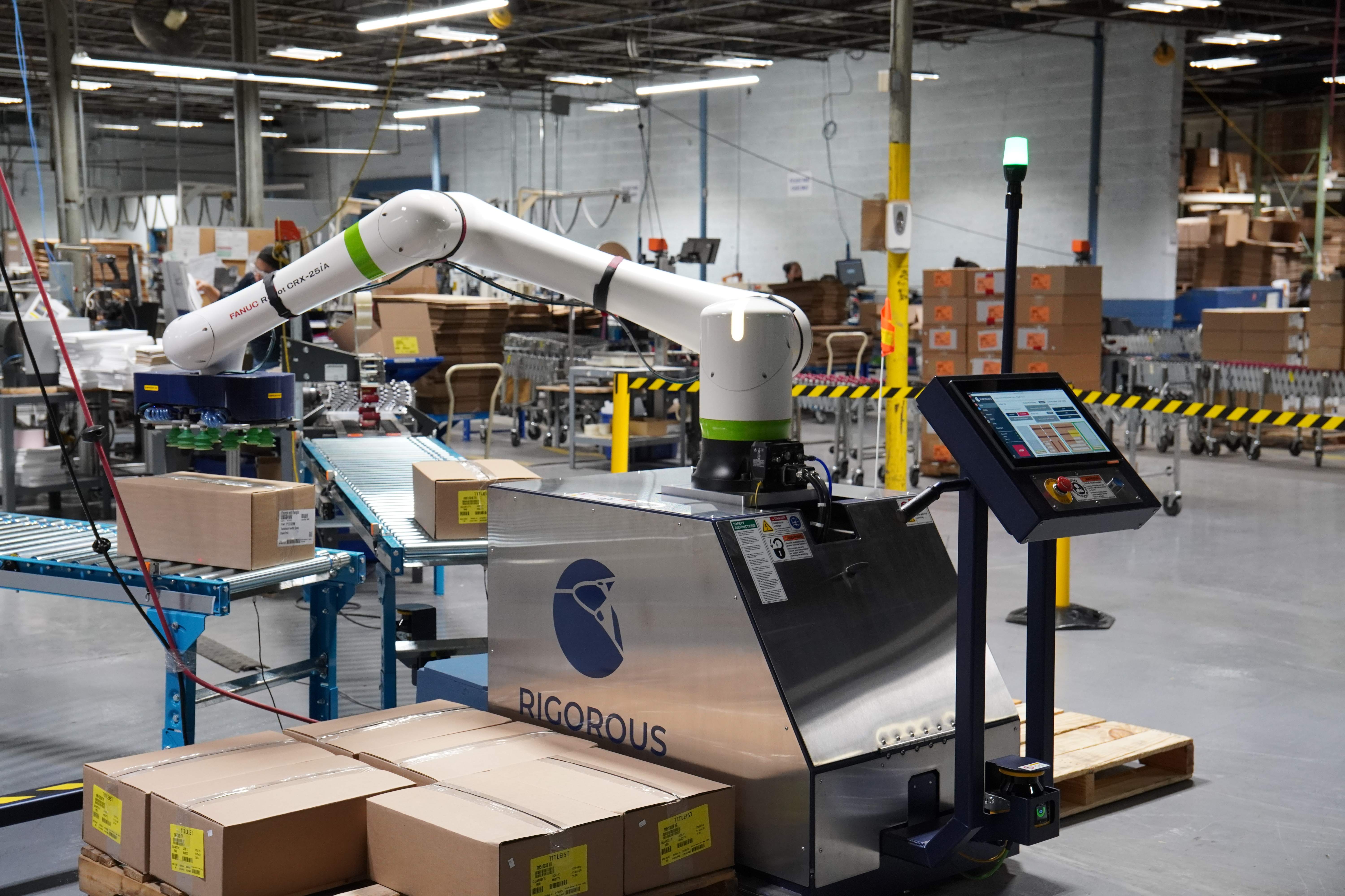

Layout Dimensions 9'2" x 12'3"
Stack Height Up to 60"
Throughput 6+ picks per minute cycle times with vision
Power Requirements 120 VAC single-phase power, 15 amps
Software Remote Motion RTL-R912, RGS Full Stack

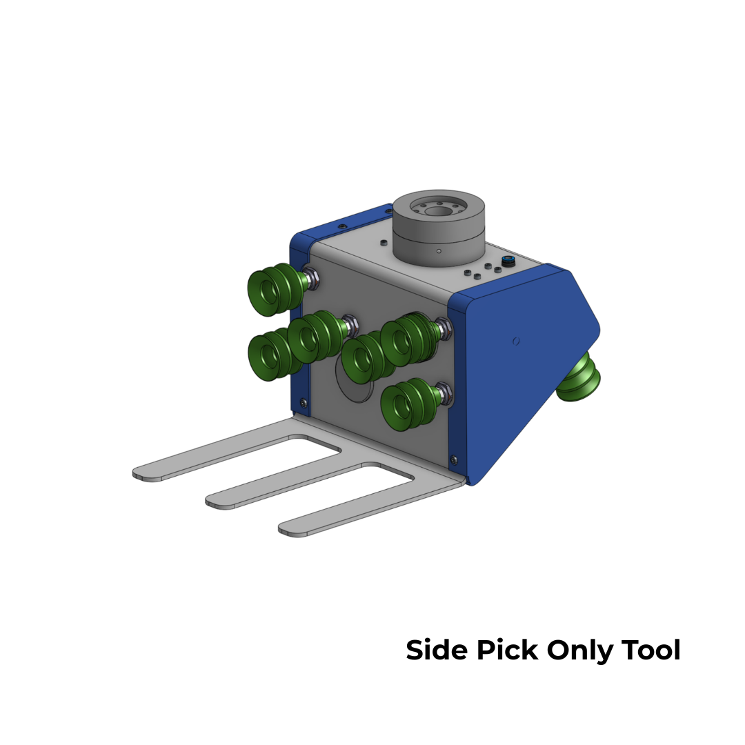

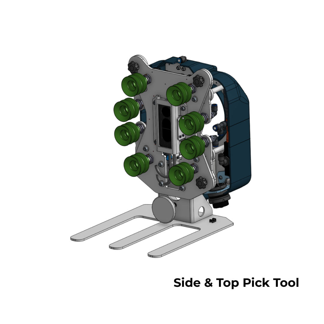

End of Arm Tooling Type(s) Customized Vacuum and Fork Tooling: RSC Top Pick with multiple adjustable vacuum zones, HSC Side/Bottom Pick with bottom forks and box pusher
Safety Four area scanners create a full safety perimeter that adjusts speed or stops when breached. Retractable safety wings allow operators to easily move and reset the RIG in new locations.
