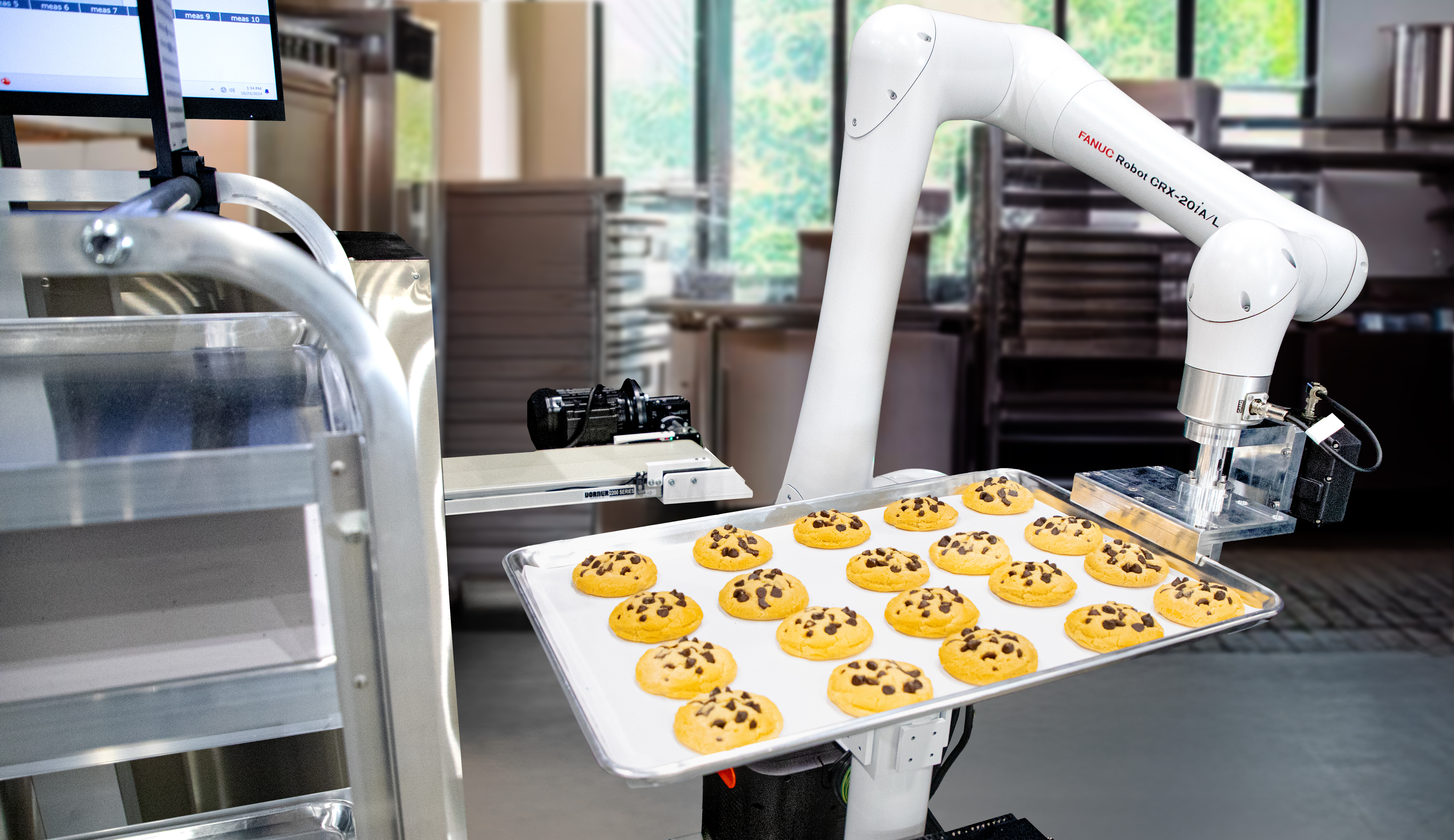

The BakerMate™ is a portable cobot platform designed to automate common bakery tasks with speed, safety, and precision. Built with hygienic, food-grade design and simple, recipe-driven changeovers, it helps bakers maximize efficiency, reduce waste, and adapt quickly to changing production demands.
