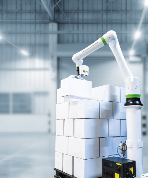

FANUC’s CRX-25iA cobot has an enhanced 30kg payload capacity and a long 1,889 mm reach, making it perfect for palletizing applications. If a higher payload capacity is needed, FANUC’s CR-35iB is the industry’s strongest collaborative robot, featuring a 50kg payload capacity, a large work envelope, and a small installation footprint, which works well in tight spaces.

With advances in FANUC’s sensor technology, the CRX-25iA and CR-35iB can be equipped with 3DV iRVision. This enables the cobots to locate and pick products on a pallet and place them onto another pallet or a platform part of an Automated Storage & Retrieval System (ASRS). Using information from the sensors, cobots can adjust their positions on the fly when the pallet location shifts. This feature gives the cobots tremendous flexibility with the ability to handle one or more units at a time according to the pallet configuration. Additionally, cobots can form multiple layers on a pallet after picking the products. Cobot palletizing solutions can easily accommodate these different pallet patterns and handle multiple infeeds of different SKUs on the same line.
