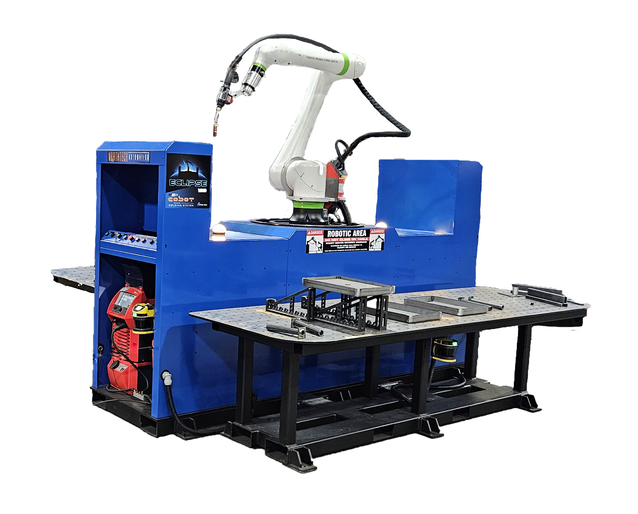

Eclipse 120 Robotic Welding System
Northtech's Dual Station Cobot Welding System featuring Tooling Tables that work with standard welding fixture kits.
Revolutionize your welding productivity with the Dual Station Cobot Welding System — engineered for speed, efficiency, and unmatched ease of use. Featuring a spacious 120” x 40” work envelope and dual operator stations, this system keeps your workflow moving while delivering premium weld quality.
Whether you're scaling up production or streamlining small-batch workflows, the Eclipse 120 is built to deliver — fast, flexible, and future-ready.

  • Long-Reach CRX 30iA FANUC Collaborative Robot
  • Motion Speeds 8X Faster Than Competitive Cobots
  • Standard System Includes OTC 400 Amp Digital Pulse Robotic Welding Package
  • Quick Job Set Up That Justifies Automated Process
  • Two 120" X 40" Operator Stations
Why Choose Eclipse 120 Robotic Welding System?
Through Northtech's extensive experience and R & D, our machines are smooth and problem free. Even with complex welding torch angles.
  •    Up to 8X Faster: Outpaces traditional cobots with fast motion speeds
  •   150% More Efficient: Boost output over manual welding with consistent, high-quality results
  •   Rapid Job Setup: Spend less time programming and more time welding — ideal for high-mix, low-volume environments
  •  User-Friendly Control: Program and operate the FANUC CRX-30iA cobot easily via Android tablet
  •  Powerful Performance: Equipped with the OTC Daihen P402 400 Amp pulse welding package for precision and reliability
  •   Seamless Workflow: Dual stations allow one side to be prepped while the other is welding
  •  Smart Cable Management: Stay safe and organized with the Northtech TunnelTek cable management system

Footprint 10.5 x 10.5
Height 9ft
Reach 1889mm
Throughput
Throughput 2x Operator Welding Stations
Power Requirements
Power Requirements 3 Phase 480 VAC, 30 Amps
End of Arm Tooling Type(s)
Tooling Type(s) MIG Welding
Software
Software ARC Tool
Safety
Number of Safety Zones 2
Including Keyence area scanners.
