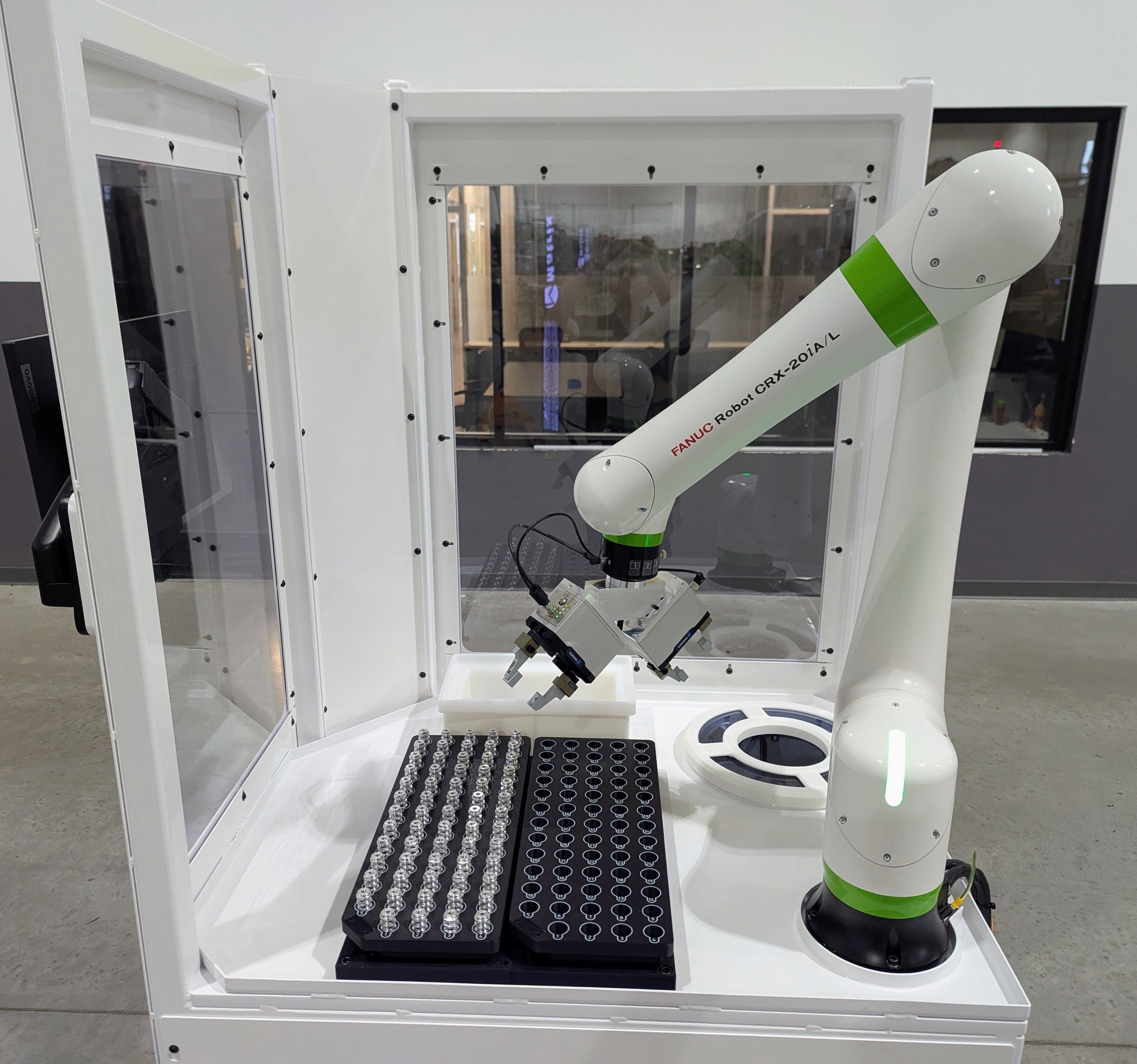

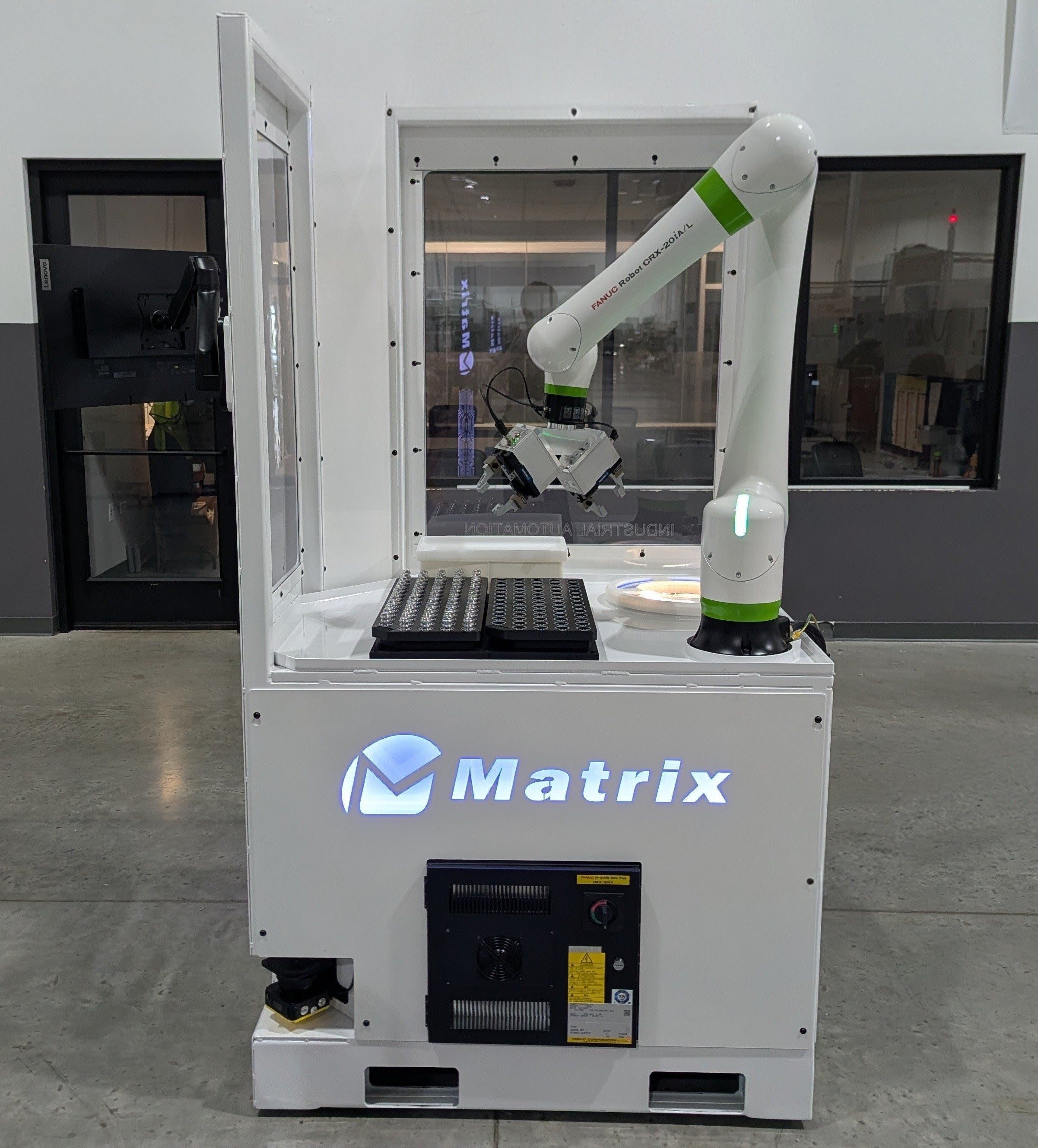

M-Tend is Matrix’s standard collaborative machine tending cell built on the FANUC CRX-20iA/L robot to pick, tend, wash, blow off, and stage parts within a compact enclosed workstation. It uses dual Schunk electric grippers, quick-change fingers, part staging nests, a wash dunk tank, and a blow-off station to create a continuous, repeatable production process from raw part loading to finished part staging.
Suitable Applications

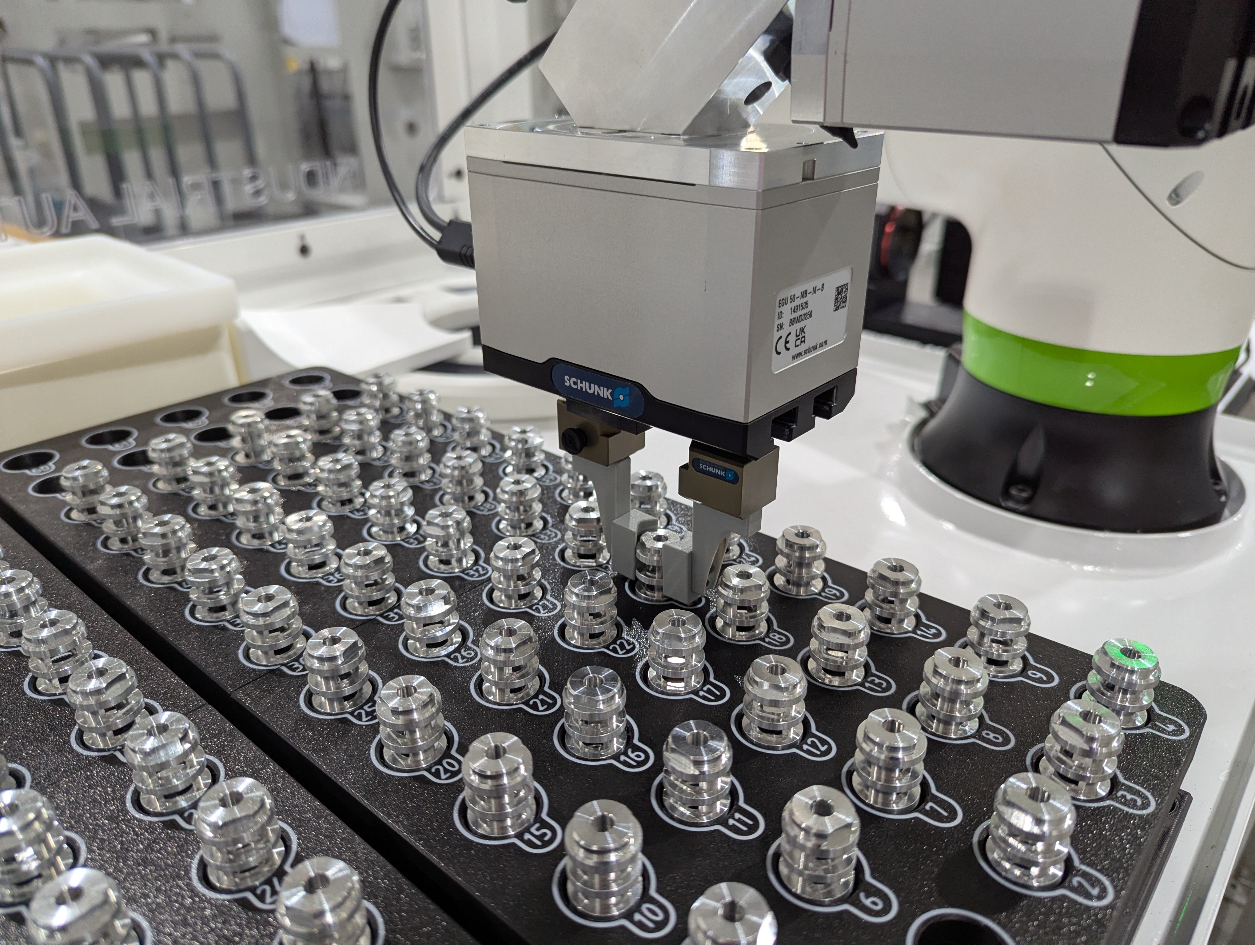

  • Machine Tending with Integrated Cleaning & Drying

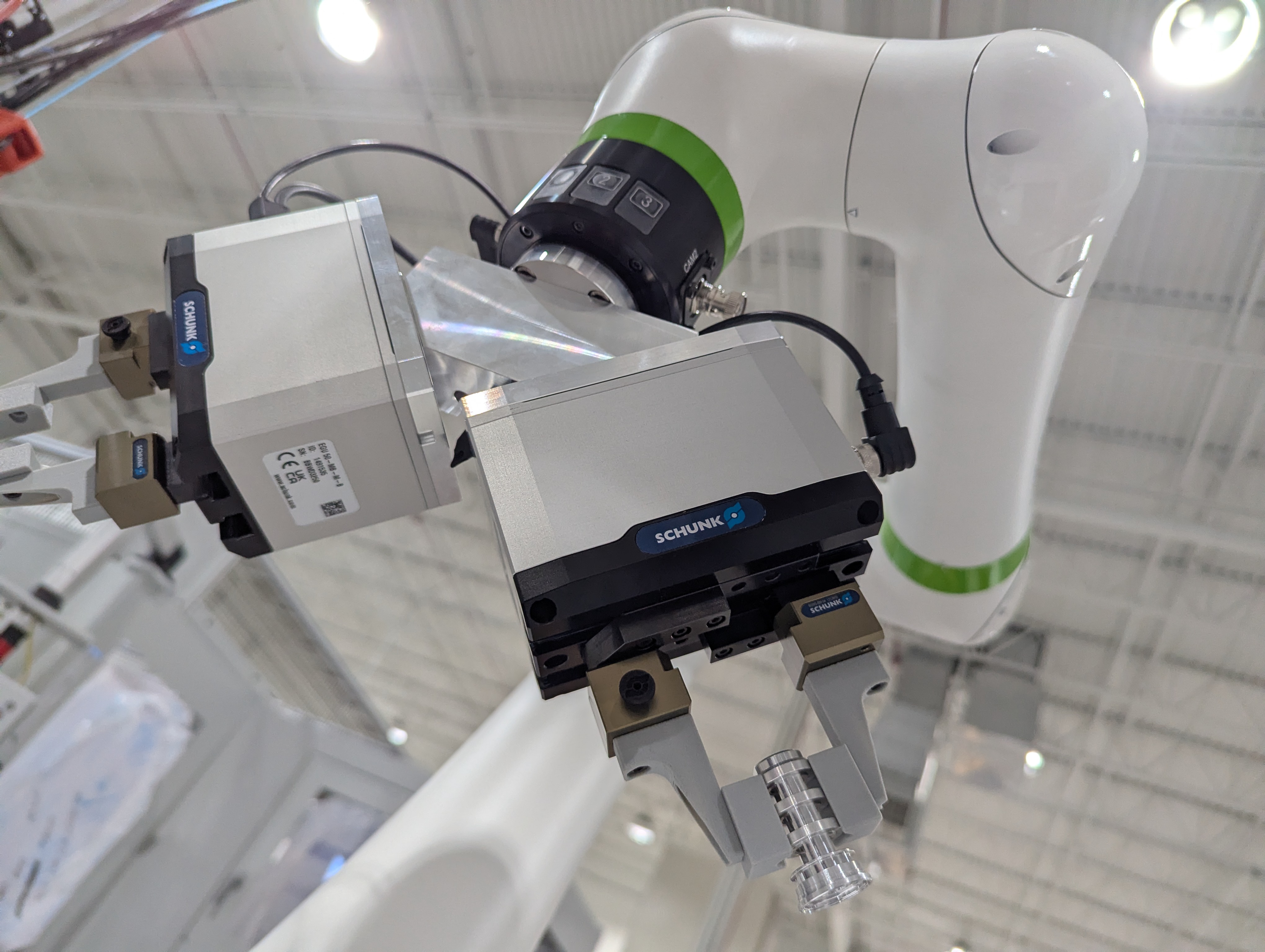

  • Dual Electric Schunk Grippers for Flexible Picking
  • Quick Change Gripper Fingers

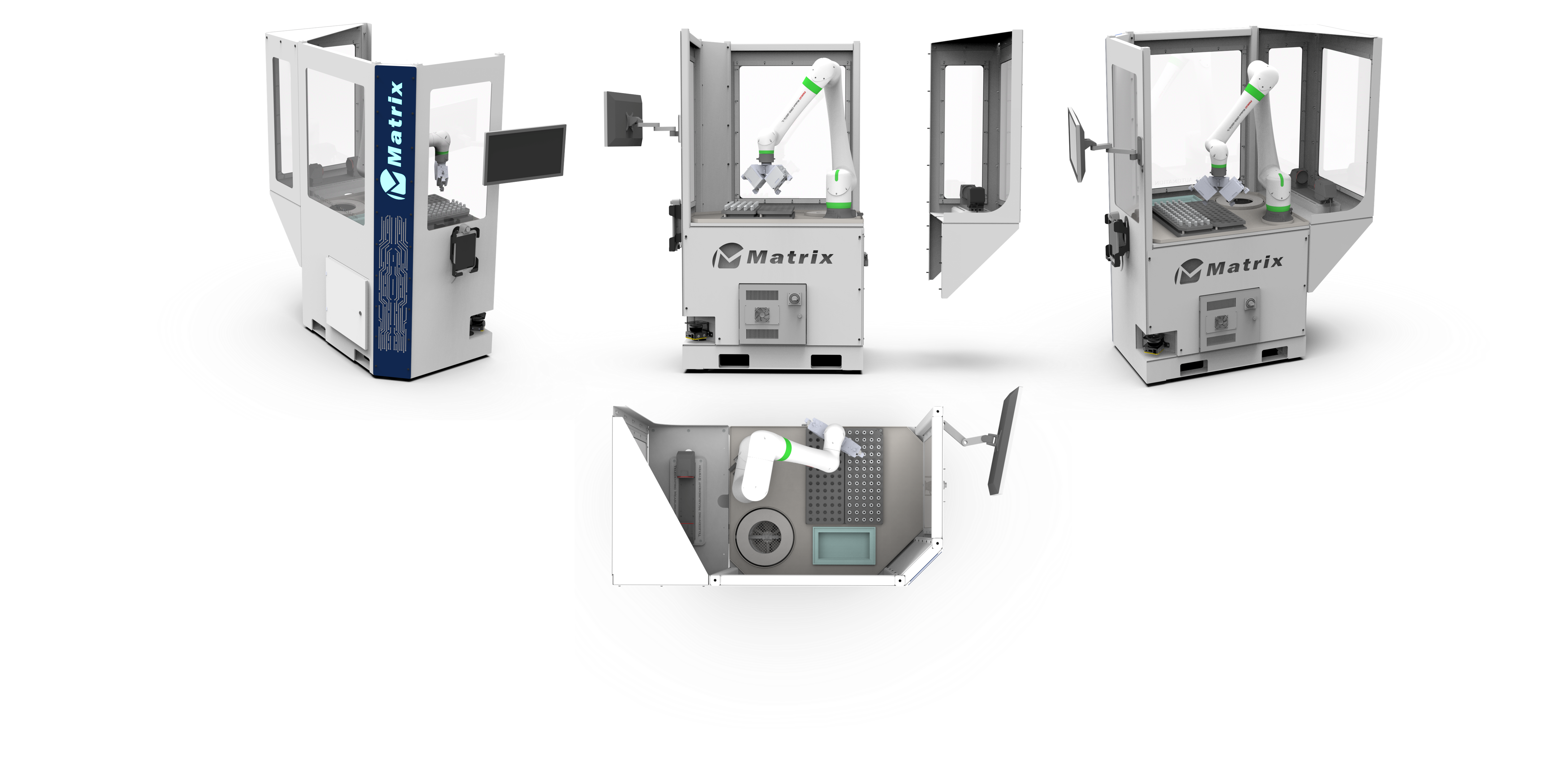

  • Modular Design, Can Add Additional Operations
  • Every Systems Comes Standard with SICK Safety Scanner
  • Palletized Base with Pallet Jack Pockets
M-Tend System Specs
Dimensions 34" W x 63" D x 82" H
Reach 1418mm
Payload 20kg (including grippers)
Throughput Application Dependent - 3-5 pieces / minute
Power Requirements Single Drop - 240VAC 30A
End of Arm Tooling Type(s): Dual Schunk Servo Grippers with Quick Change Fingers
Safety Integrated area scanner standard on all
Matrix will perform an A3/RIA safety risk assessment on all applications
