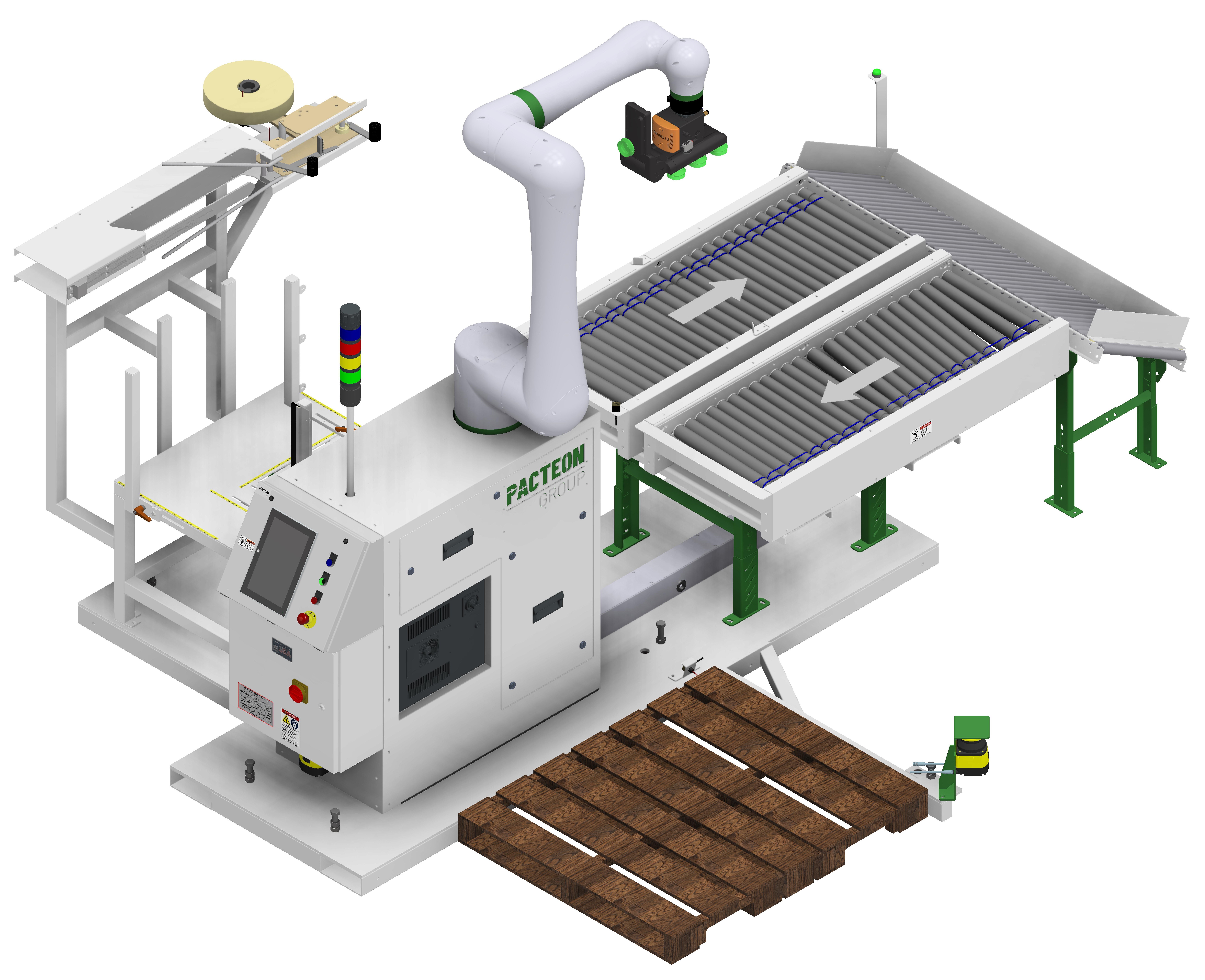

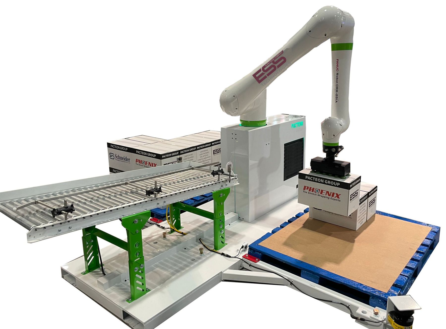

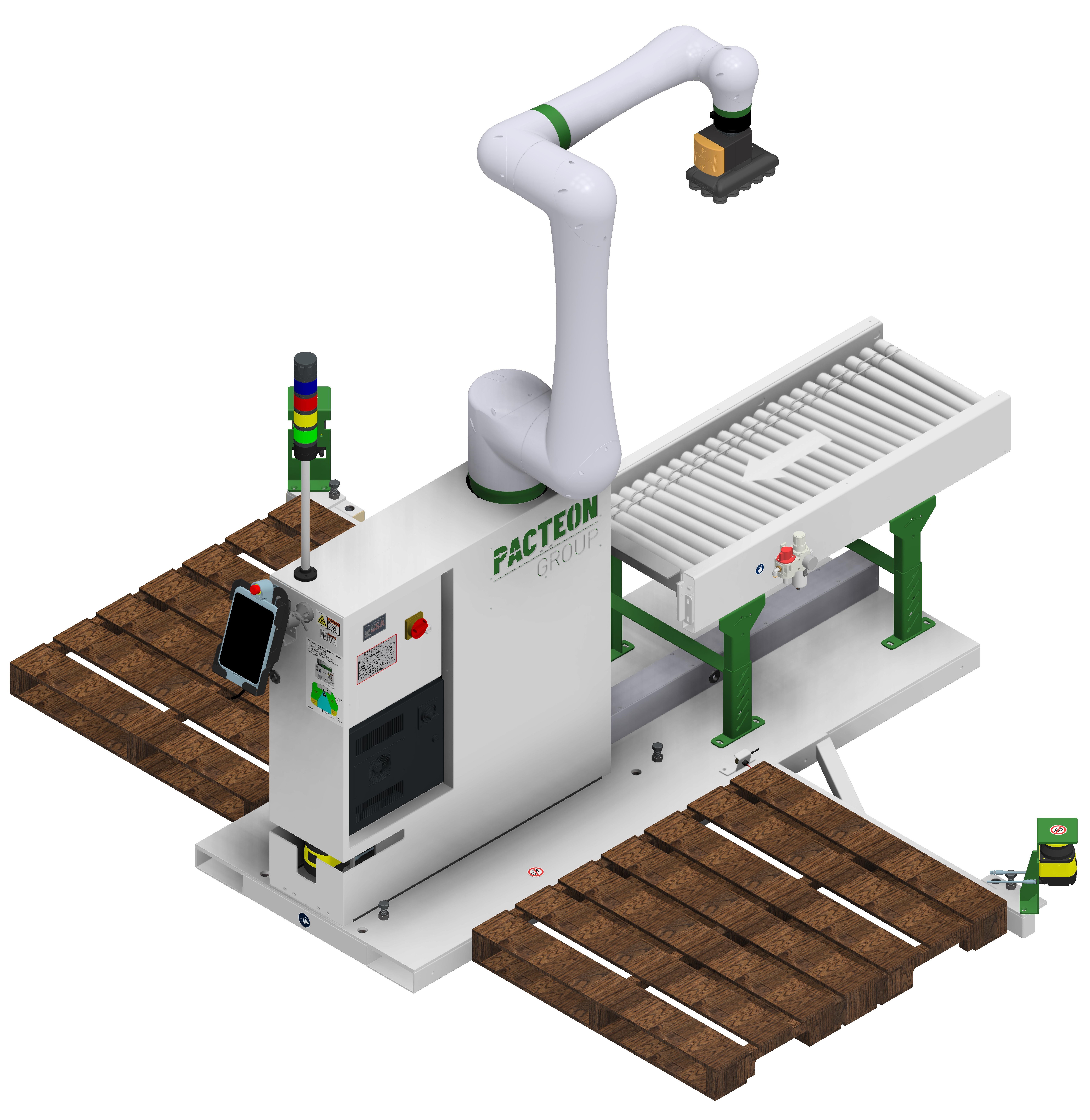

The Pacteon Collaborative Robotic Pallet Cell is an advanced solution designed to streamline the palletizing process in manufacturing environments. It features a FANUC CRX Series collaborative robot equipped with ESS-designed vacuum-style end-of-arm tooling (EOAT). This setup allows for efficient and precise handling of cases, creating a compact palletizing cell suitable for both single and dual pallet configurations. The collaborative nature of the robot means it can operate safely alongside human workers without the need for extensive safety guarding, significantly reducing the system's overall footprint.
In addition to its compact design, the Pacteon Collaborative Robotic Pallet Cell offers several customizable options to meet specific production needs. These include a tier/deck sheet magazine with placement, integration with OEM serialization systems, and various payload capacities depending on the chosen robot model. The system is designed for easy deployment and operation, making it an ideal choice for manufacturers looking to enhance productivity and maintain high safety standards. By automating the palletizing process, the Pacteon system helps reduce labor costs and improve overall efficiency in the production line.
