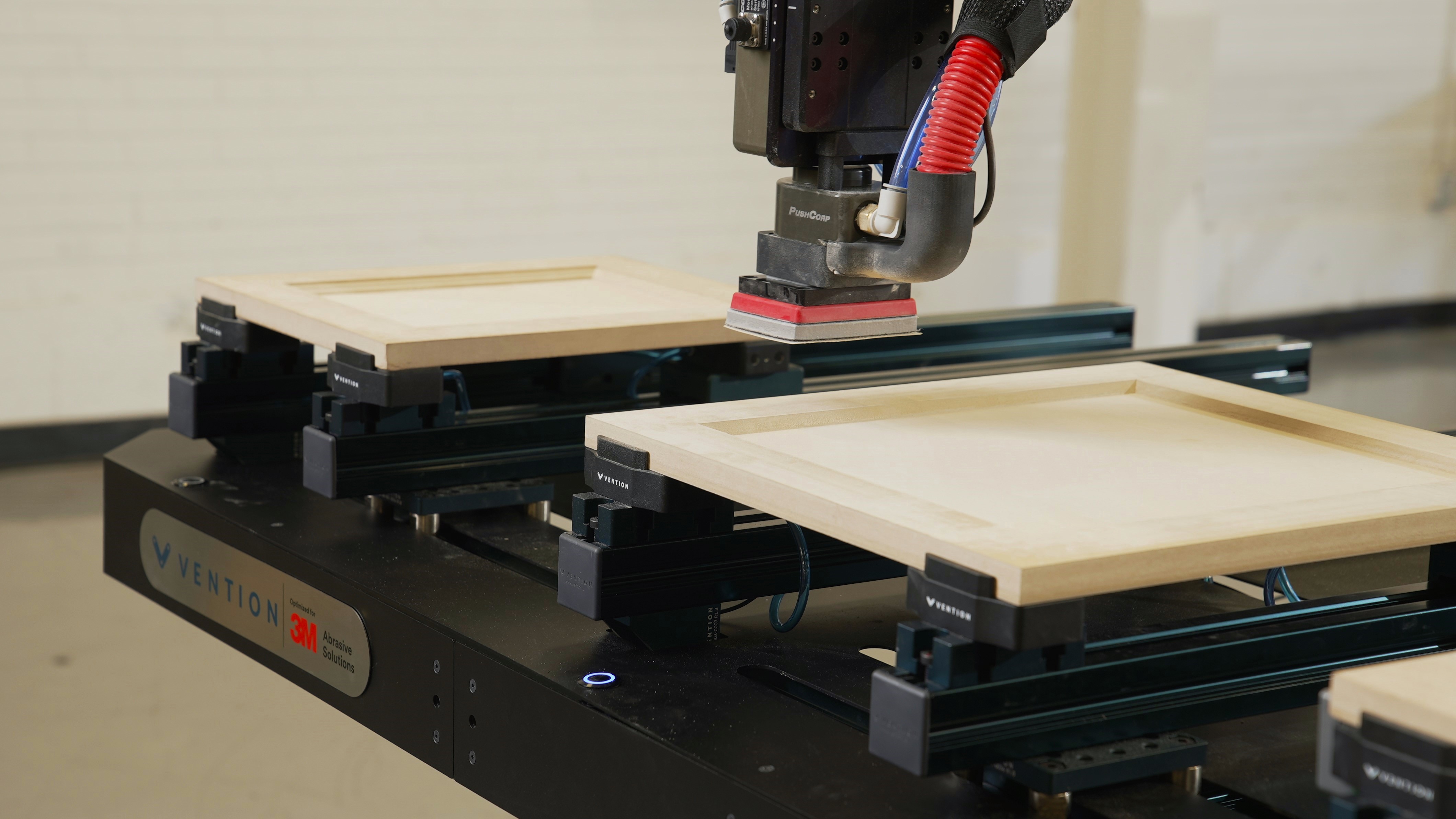

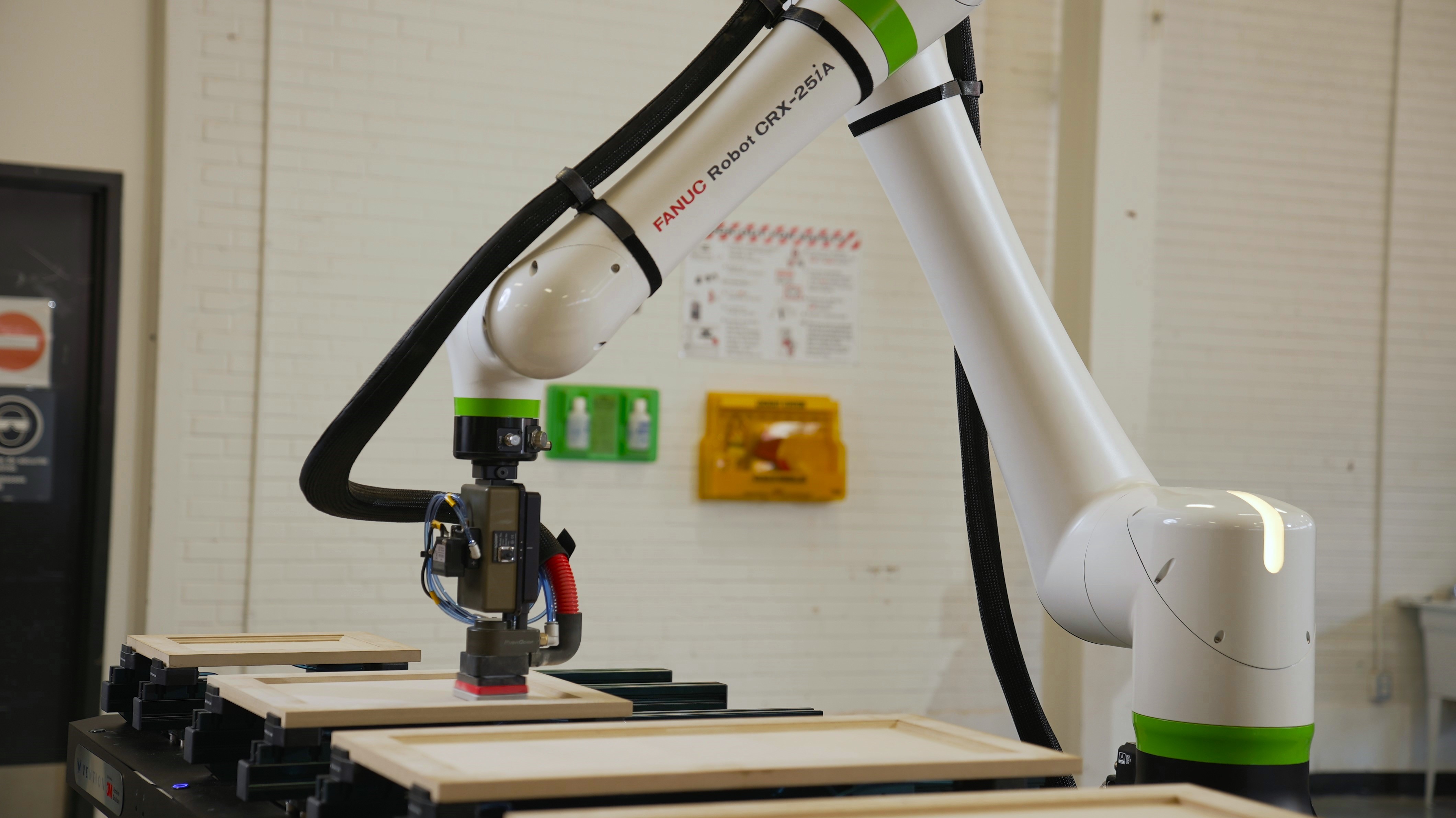

Vention’s Robotic Sanding Solution is designed to help woodworking manufacturers achieve consistent, high-quality finishes with ease. Equipped with a FANUC CRX-30iA collaborative robot and a PushCorp rectangular sanding tool, the system ensures uniform results across various cabinet sizes and designs. Its compact, plug-and-play design integrates seamlessly into workshops, running on standard 120V outlets and air lines, making deployment quick and straightforward.

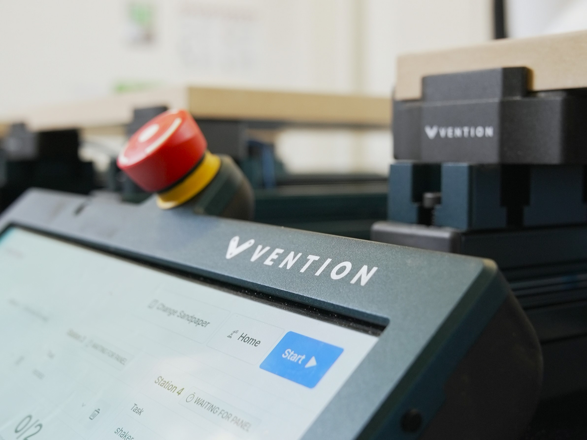

This solution’s intuitive software allows operators to create and fine-tune sanding recipes directly on the shop floor, ensuring precision and repeatability for every job. Optimized for use with 3M abrasives, it delivers professional-grade finishes while reducing the variability common in manual sanding processes. With robust remote support for troubleshooting and maintenance, manufacturers can minimize downtime and maintain consistent production quality.

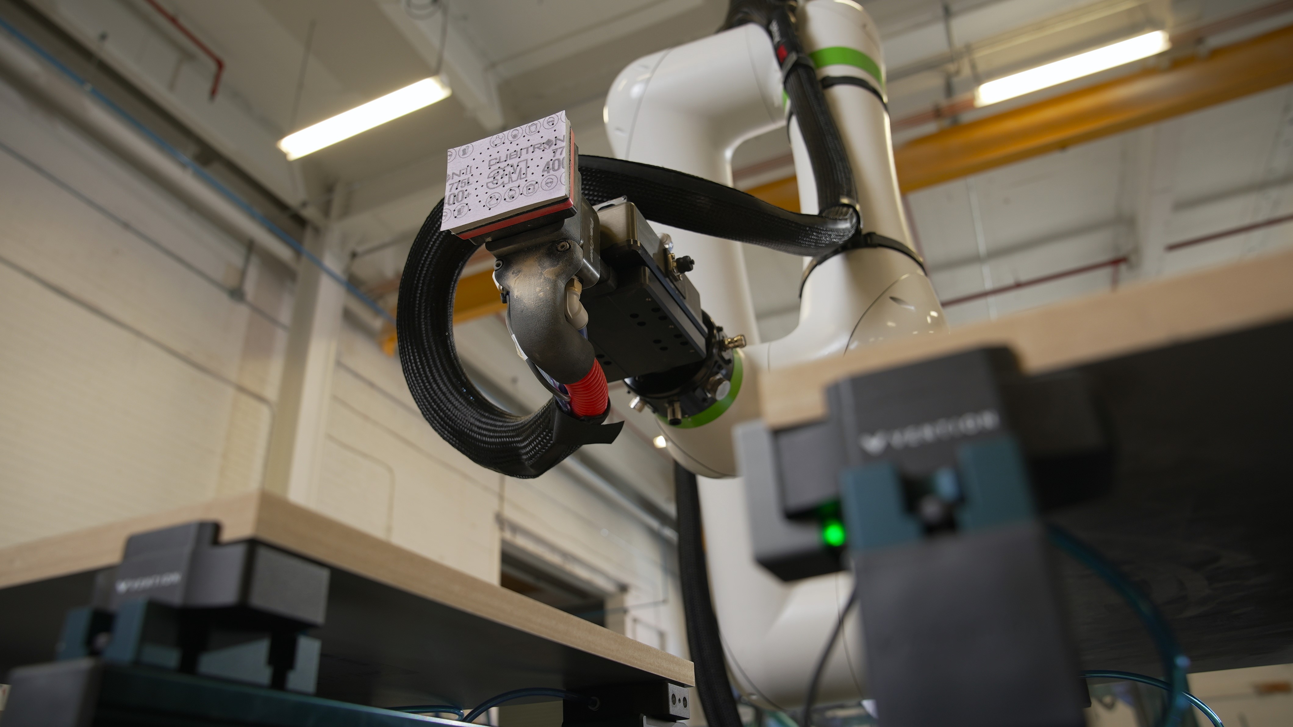

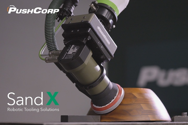

PushCorp Pneumatic Orbital Sanding Rectangular pad (4x3 in) & passive compliance
Dust Extraction 3M Xtract™ Portable Dust Extractor or central dust extraction
Abrasives Included 3M™ Cubitron™ 2 Hookit™ Film Sheet 775L, 3M™ Hookit™ Clean Sanding Sheet 236U

Vention MachineApp Sanding Software Easy touchscreen interface to Create sanding recipes, no programming required
