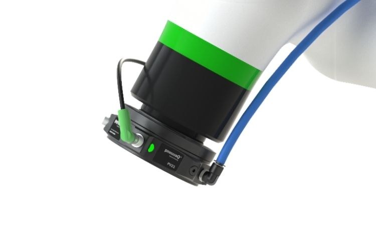

pneuvaQ by Impaqt Robotics is a compact, integrated pneumatic and vacuum interface that enables the development and operation of customized tooling requiring both pneumatic actuation and vacuum on FANUC CRX cobots. Designed as a standardized interface, it consolidates pneumatic control and vacuum generation into a single device, reducing tubing, external components, and engineering effort when deploying customized EOAT.

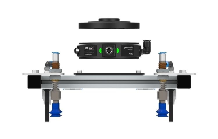

pneuvaQ is designed for automation scenarios where EOAT is custom-built and must combine pneumatic motion with vacuum gripping in one tool. Instead of engineering separate pneumatic circuits and vacuum systems for each application, pneuvaQ provides a common interface that integrators can design around when developing application-specific EOATs.
By standardizing how compressed air is supplied and managed within the tool, pneuvaQ simplifies EOAT design, improves consistency across projects, and makes it easier to adapt or replicate custom tooling for different machines or production lines. Typical applications include machine tending, injection moulding, press brake automation, and other use cases where custom EOATs are required.

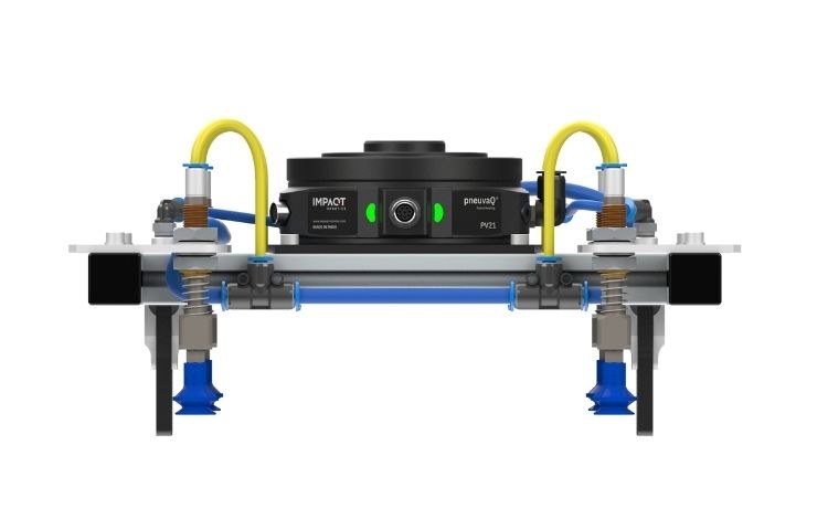

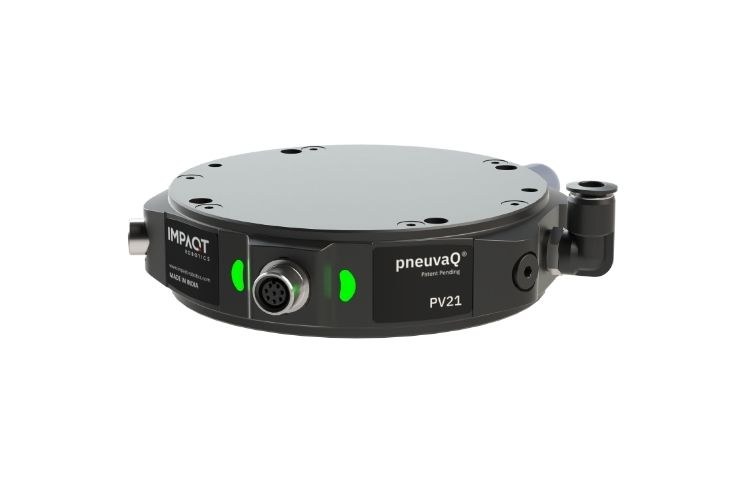

pneuvaQ PV21 – Two Compressed Air Outlets and One Vacuum Outlet
The pneuvaQ PV21 integrates two compressed air outlets and one vacuum outlet into a single interface supplied by one pneumatic inlet. Internally, it manages air distribution to supply pneumatic actuation and vacuum for gripping within the same custom EOAT. This enables compact, application-specific tooling for machine tending, injection moulding, and press brake automation, without the need for external valve blocks or separate vacuum generators.
pneuvaQ Speicifcations
Dimensions 120 x 105 x 24 mm
