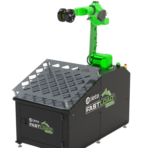

Acieta FastLOAD® CR2000

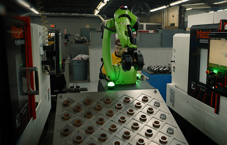

The CR2000 from Acieta is designed to simplify the automation process with its intuitive touchscreen HMI, enabling quick part setup and parametric programming without the need for prior programming experience. This versatile system can tend to two machines simultaneously, enhancing productivity. It offers standard grid plate options to accommodate various part sizes and is available in 2 and 3-jaw EOAT configurations, which include adjustable finger sets and an air blow-off feature. Additionally, the FastLOAD® CR2000 collaborative robot allows for safe human intervention during operation, making it a user-friendly and efficient solution for various manufacturing needs.
| Overall Length | 1791.1 mm (70.52 in) |
| Overall Width | 1035 mm (40.75 in) |
| System Weight | 1040 kg (2293 lbs) |
| Min Part Height | 20 mm (0.79 in) |
| Max Part Height | 250 mm (9.84 in) |
| Min Part Diameter or Width | 16 mm (0.63 in) |
| Max Part Diameter or Width | 144 mm (5.67 in) |
| Gripper Options | Two jaw gripper for square parts or three jaw gripper for round parts |
| Throughput | Variable |
| Power Requirements | 480 VAC at 3KVA |
| End of Arm Tooling Type(s) | 2 Jaw Back to Back |
| 3 Jaw Back to Back | |
| 3 Jaw Offset | |
| Software | Guided HMI |
| Safety | Area scanners and radar scanners are optional |
| Compliant Machine Types and Brands | No additional hardware required for all machines with ethernet IP robot interface. |
| Discreet I/O interfaces are available for most CNC equipment manufacturers | |
