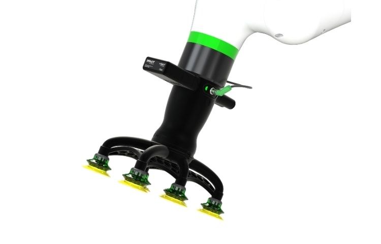

- Fixed or telescopic column with base platform
- vaQgrip vacuum gripper

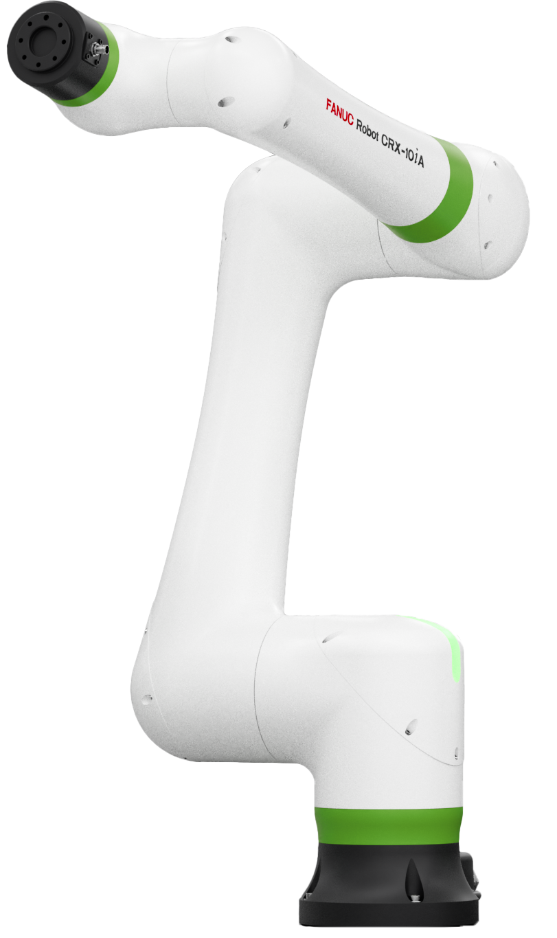

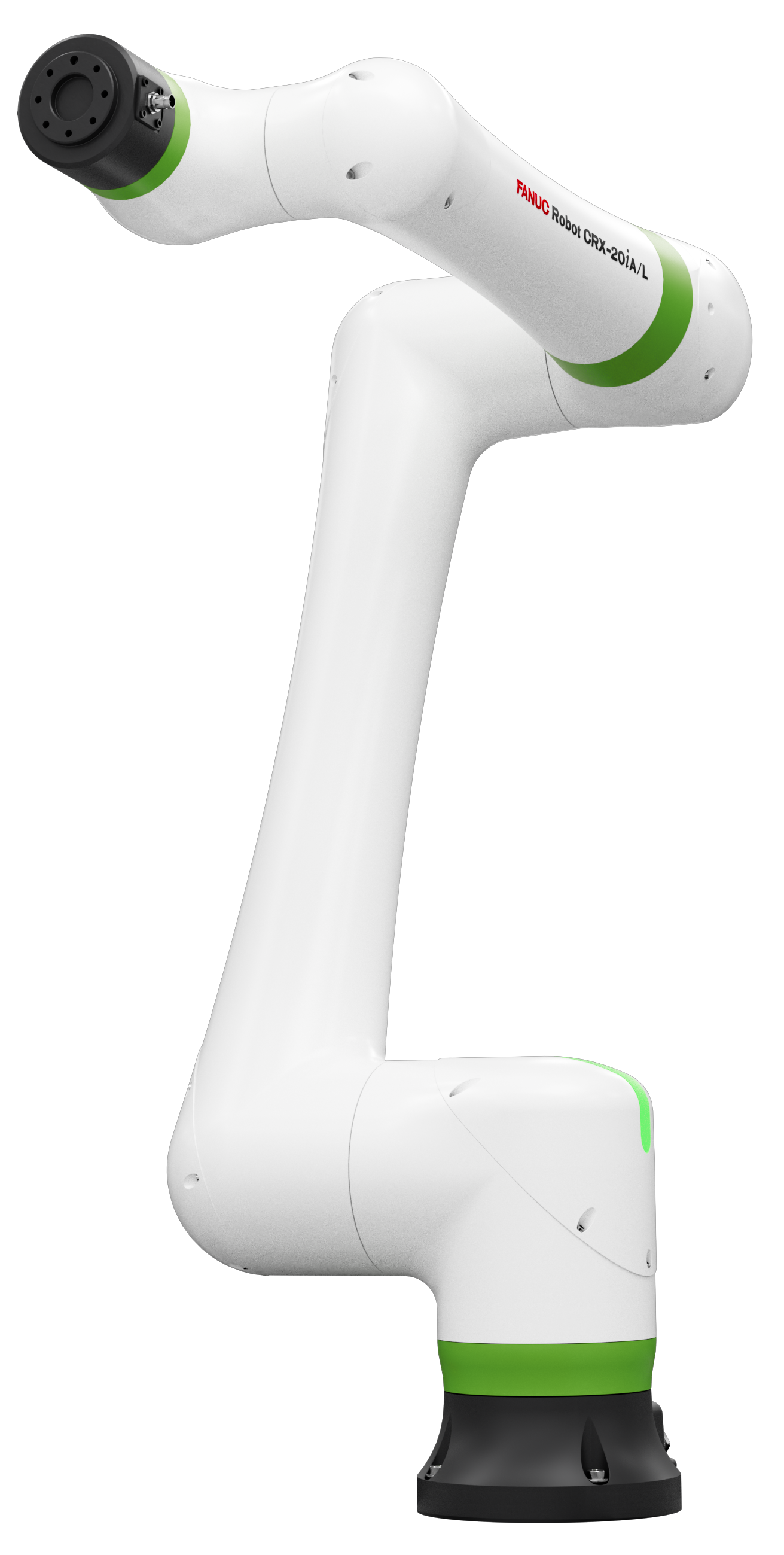

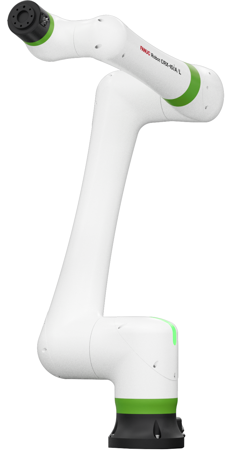

cobotizur CT Series
cobotizur CT is the telescopic column series for low-payload palletizing applications where adjustable working height and flexibility are important. It supports payloads up to 11.5 kg and stack heights up to 1,800 mm, providing a compact setup for applications where working height may need to change.
cobotizur CF Series
cobotizur CF is the fixed column series for palletizing applications that require higher payload capacity, maximum reach, and taller pallet builds. It supports payloads up to 30 kg and stack heights up to 2,590 mm, covering applications across a wider payload and pallet height range.
