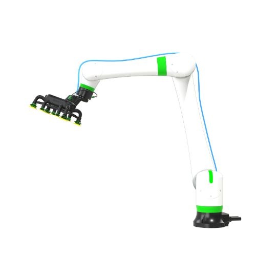

vaQgrip by Impaqt Robotics is a family of plug-and-play vacuum grippers designed to make vacuum automation faster, cleaner, and easier to scale. Built around a lightweight architecture with internal vacuum routing, vaQgrip eliminates external tubing and fittings, reducing clutter and cutting installation time to just minutes.

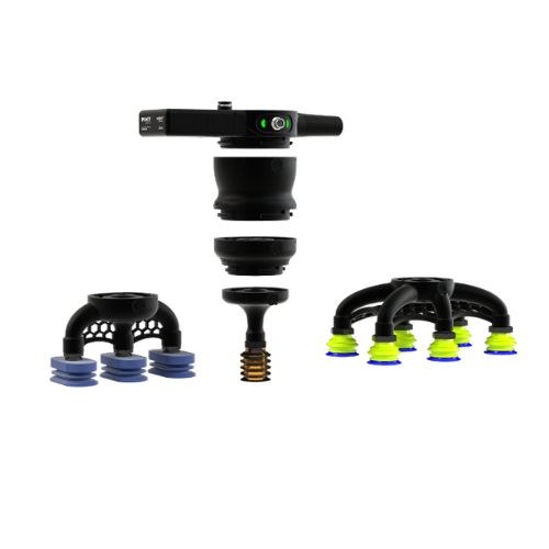

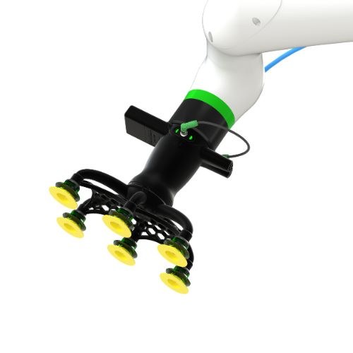

vaQgrip Click – Modular Vacuum Gripper System
vaQgrip Click is the modular member of the vaQgrip family, designed for applications that require flexibility. Its tool-free, twist-to-connect architecture allows gripper layouts to be built, modified, and expanded without custom fabrication, while internal vacuum routing eliminates external hoses. This makes vaQgrip Click suitable for multi-SKU production and applications with frequent layout changes.

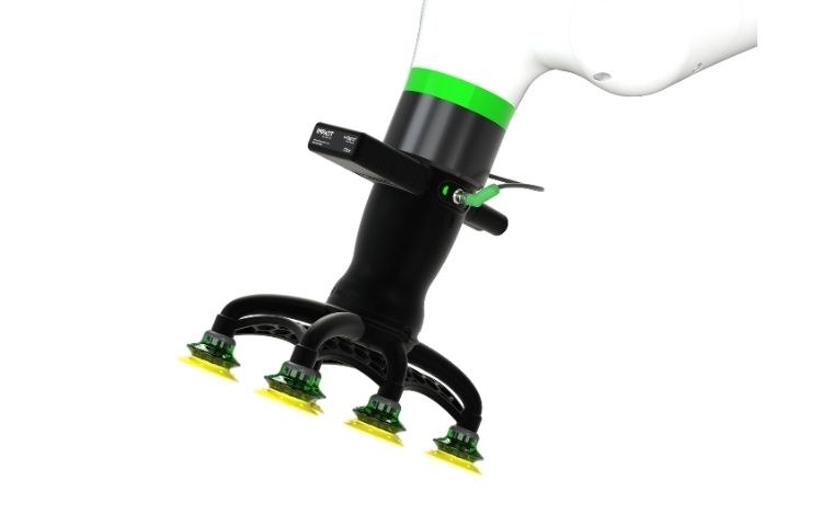

vaQgrip VQ10 – Lightweight Vacuum Gripper, 10 kg Payload
The vaQgrip VQ10 is a plug-and-play vacuum gripper designed for palletizing and material handling. Weighing 1 kg and supporting payloads up to 10 kg, it offers an excellent weight-to-payload ratio for collaborative and industrial robot cells. An integrated horizontal offset extends reach in palletizing applications, while dual-channel vacuum and internal routing provide reliable operation in compact, repeatable setups.

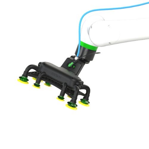

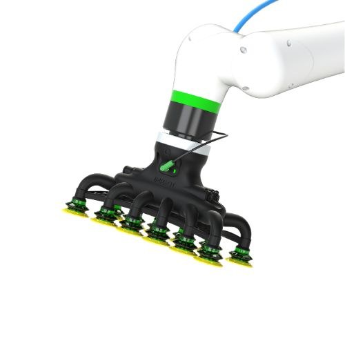

vaQgrip VQ20 – Lightweight Design, High-Payload Performance
The vaQgrip VQ20 extends the series to higher payload applications, handling up to 20 kg with a gripper weight of approximately 1.2 kg. Dual-channel vacuum provides stable gripping for high-volume palletizing and multi-carton handling. With internal vacuum routing, plug-and-play installation, and a compact mechanical design, the VQ20 supports efficient deployment in demanding industrial environments.
