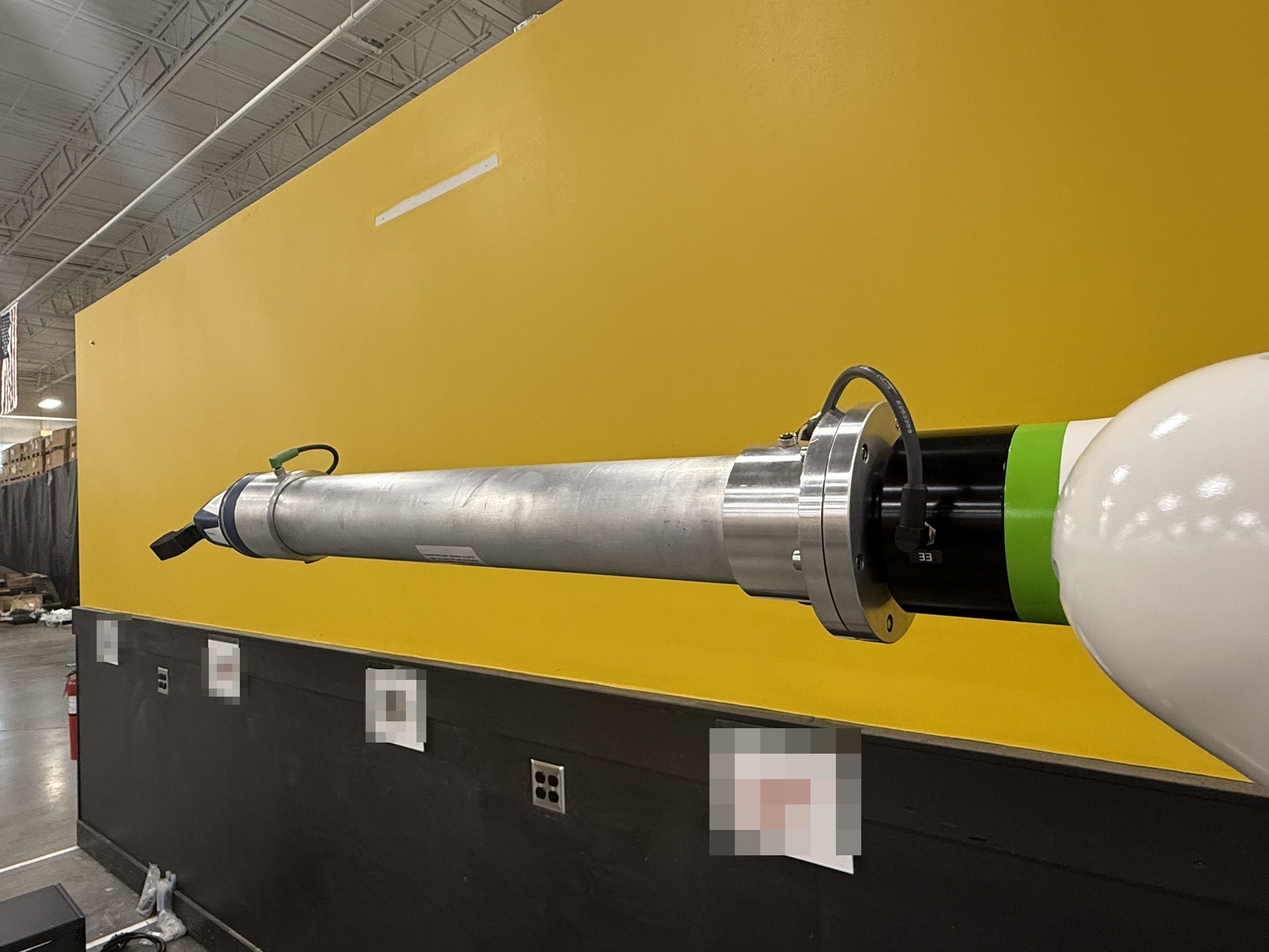

Techreo's Reach Extender extends the reach of cobots up to 610mm (24”) using a patented composite design which provides lightweight, low deflection, and built-in vibration damping. Anytime you want to reach further, Techreo’s reach extender reaches out in lengths from 305mm (12”) up to 610mm (24”) using a fraction of the J5 moment. Simple jumpers enable plug-n-play connections: with electric and air lines protected by going thru the inside of the structure. Extend your cell’s reach, protect your CRX from damage.
Suitable Applications
Includes CRX Plugin
No- Our largest model - at 610mm (24") - consumes only 15% of the J5 moment for a 20iA/L.

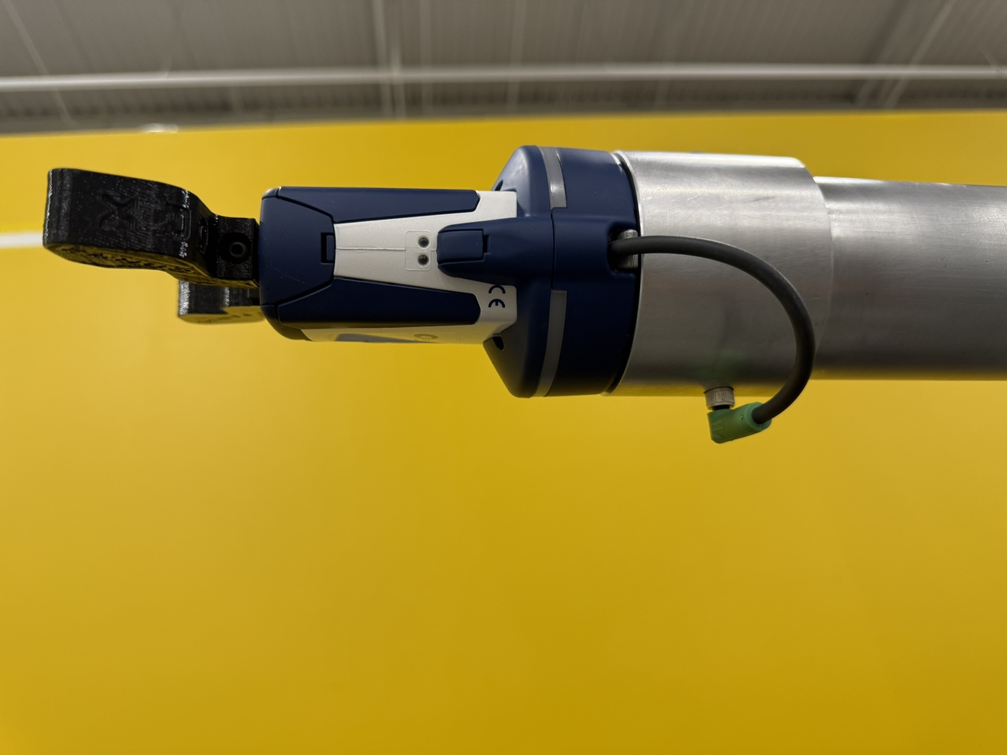

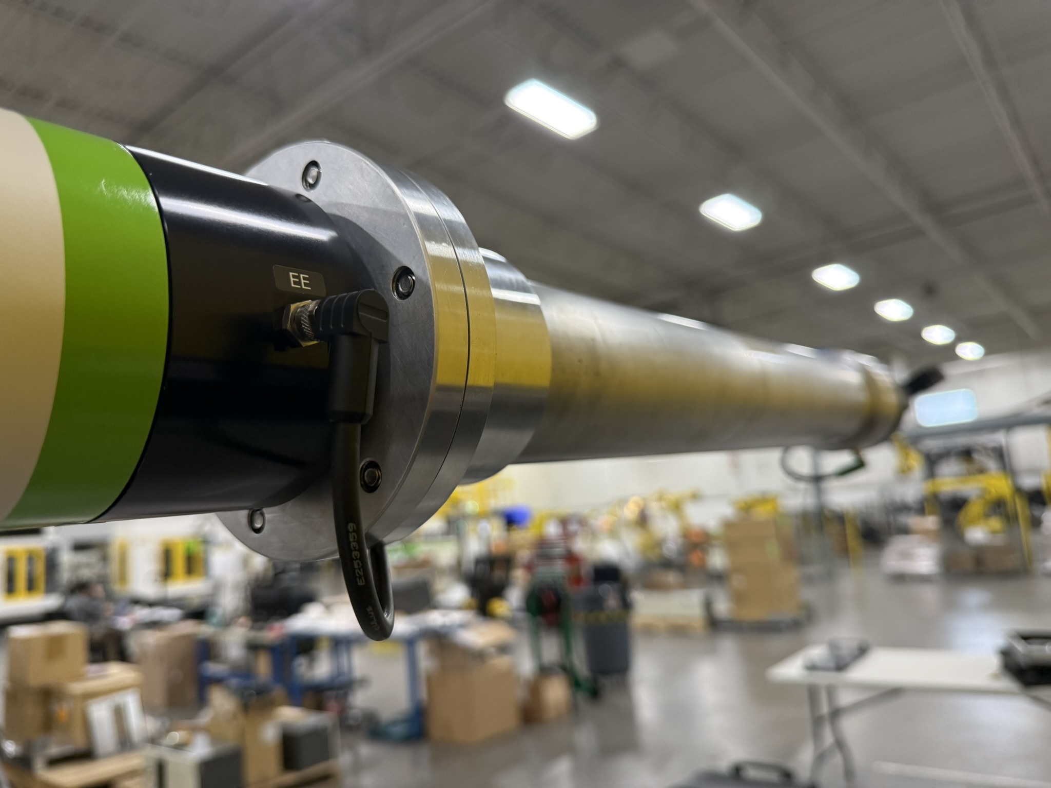

- Plug and Play: Our wrist flange bolts directly to an adapter plate which is configured to your cobot's wrist (often ISO 50). For utilities, simple jumpers are required at the wrist for both electrical and pneumatic - the lines are protected thru the interior of the structure and are available at the tooling end.
- Versus aluminum, Techreo's composite tubing is 35% lighter, 20-40% less deflection, and up to 50x faster vibration damping.
