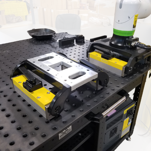

Magswitch arrays can be anchored flat or pivoted to allow mounting to cylindrical ferromagnetic surfaces and feature a wide footprint to reduce the risk of peel and pry when the end effector is at its greatest radius. Refer to the dimensional drawing below. The standard mounting plate is ready for mounting FANUC CRX-10 COBOTS. Custom mounting plate and patterns can be incorporated; contact Magswitch for more information about customization.
Includes CRX Plugin
No
In the ever-evolving world of automation, collaborative robots (cobots) are reshaping how work gets done — from factory floors to field-based repair sites. At the foundation of many of these robotic applications, there is a need for strong, flexible, and reliable mounting solutions. Enter the Magswitch MagBase Family: a powerful lineup of magnetic bases that simplify how you mount, move, and automate across a wide range of industries.

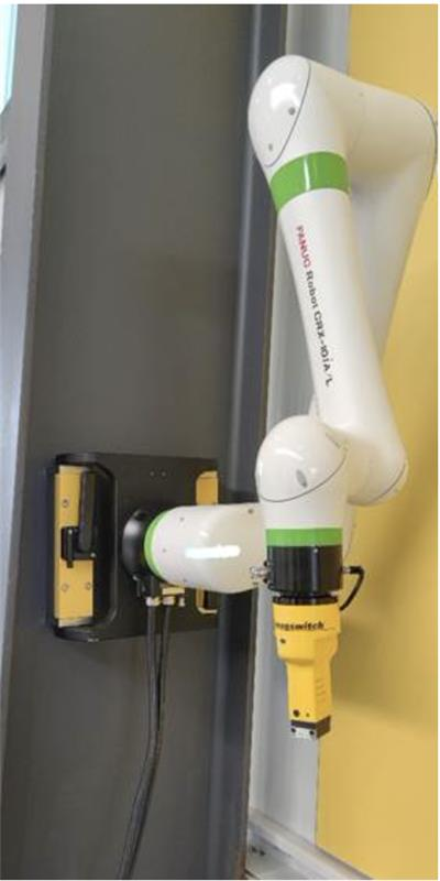

At the heart of this family is the Magswitch MagBase 10, a compact yet powerful solution designed specifically for cobot mounting. With a wide magnetic footprint and pivoting magnets, the MagBase 10 ensures secure attachment on both flat and cylindrical ferrous surfaces, making it ideal for dynamic applications, such as assembly, inspection, and welding. With over 1,300 pounds of holding force on 0.25-inch steel and exceeding 2,000 pounds on thicker materials, it provides unmatched grip and confidence in high-demand environments.
What sets the MagBase 10 apart is its field versatility. Whether you are working in a structured factory environment or performing vertical welds on the side of a ship, the MagBase 10 anchors cobots quickly and securely — no external power required. It is the go-to solution for integrators and welders looking to reduce setup time while boosting precision and safety.
