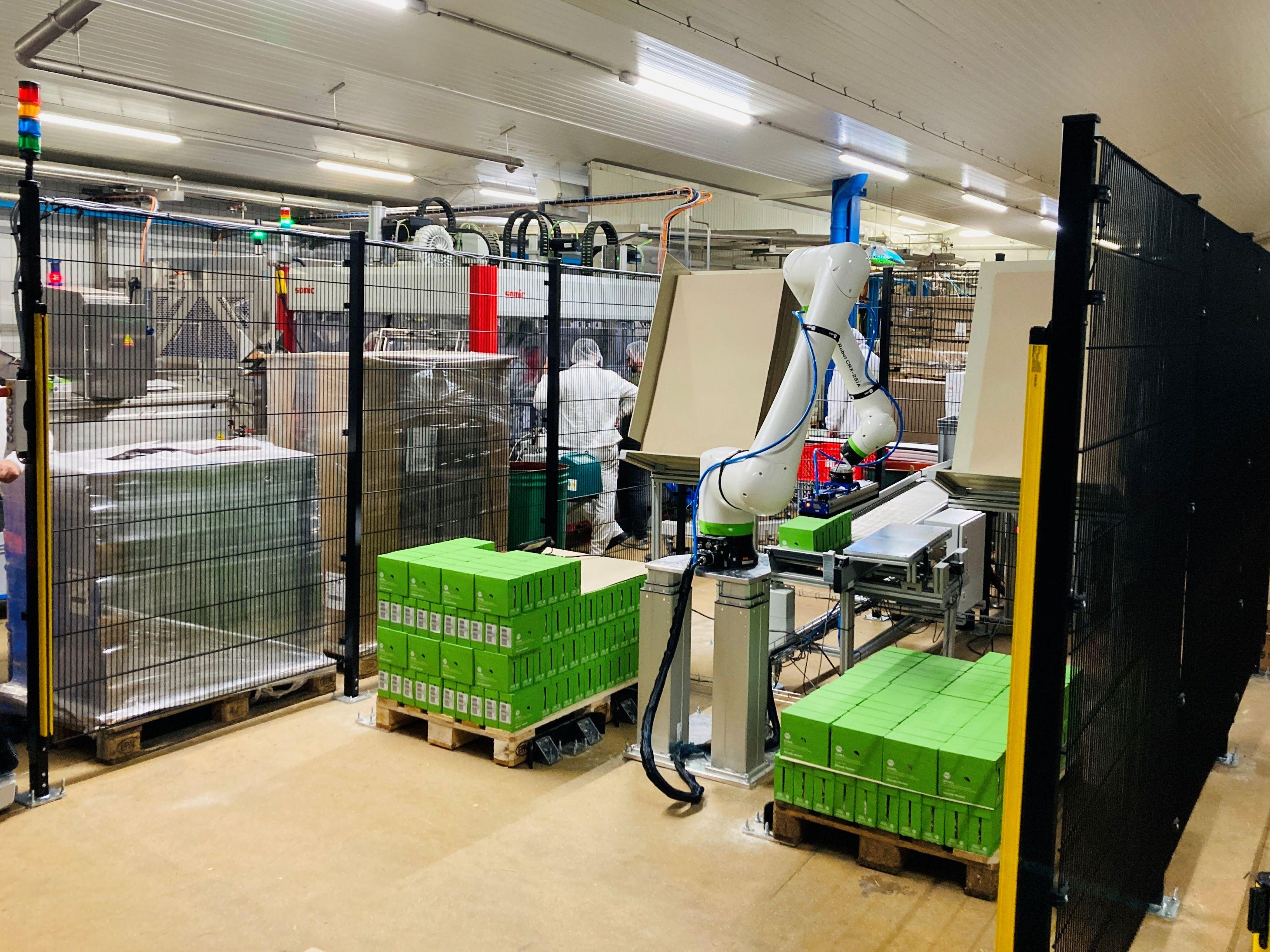

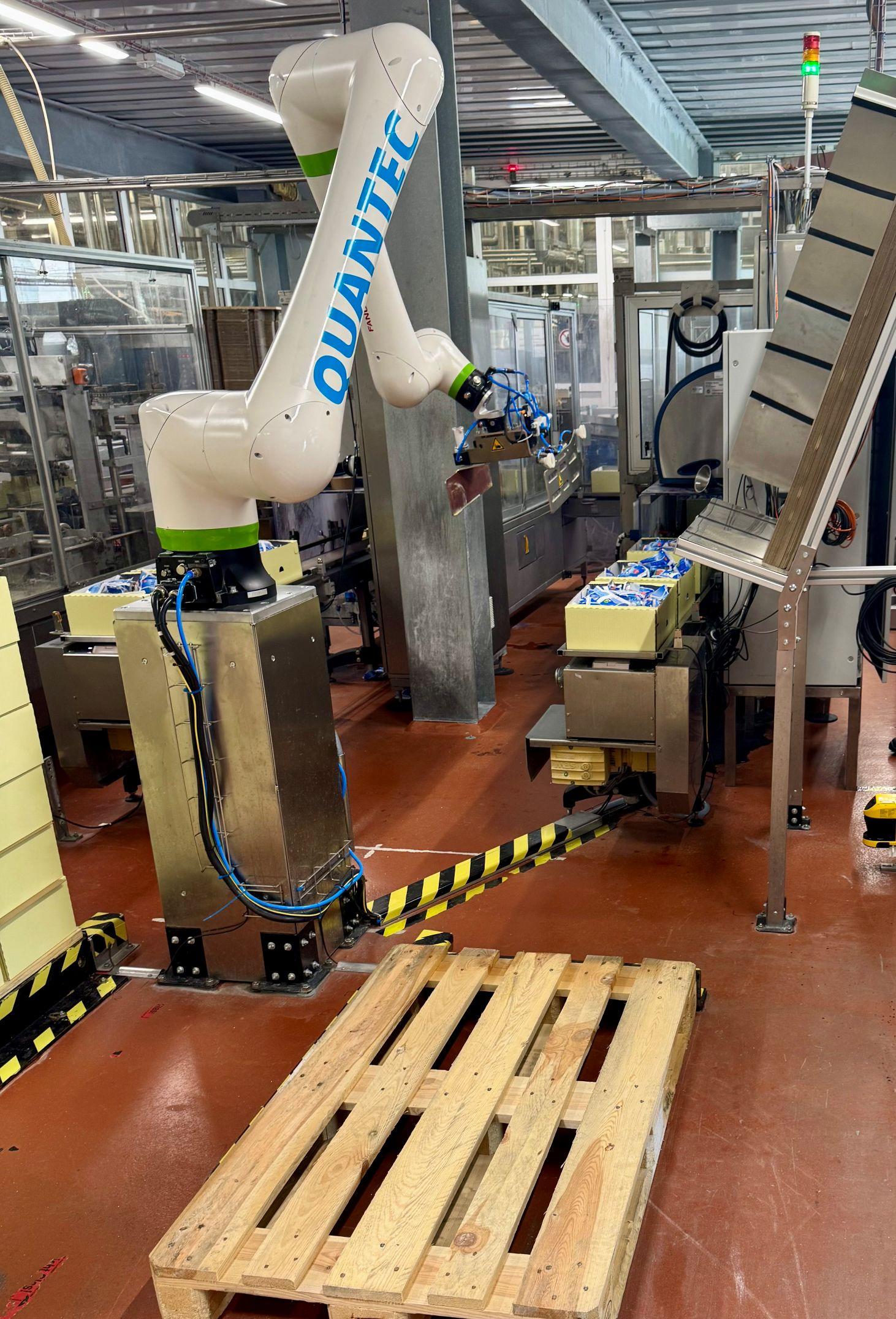

Our QUANTEC Palletizer (QP) enables the automation of palletizing processes in an efficient and economically attractive way. Experience an automation solution that saves time and can be flexibly integrated into your production. With our QP you can minimize your manual work processes and increase productivity and ergonomics at the workplace. Our innovative concept, including a graphical user interface, guarantees maximum flexibility through mounting of the arm with minimal footprint and a practical control unit.
Suitable Applications
- Maximum spacial flexibility through innovative structure with podest or lift and separate controll tabel or stand-alone control cabinet
- Simple graphical user interface with fast teaching of new variants through parameterization
- Maximum payload of 30 kg including the gripping system
- Pre-configured communication interfaces (Profinet, Profibus, Ethernet IP, Digital I/Os)
- Remote maintenance capability and OEE data collection & analysis
- Collaborative system with required safety certification
