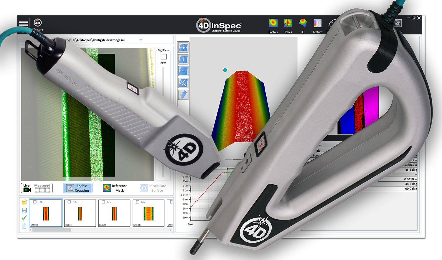

The 4D InSpec surface gauge is a precision instrument for non-contact surface defect measurement. With micrometer-level resolution, portability, affordability and ease-of-use, 4D InSpec puts high-resolution 3D surface measurement where it’s needed: on the factory floor, in machine shops, and in field maintenance applications.

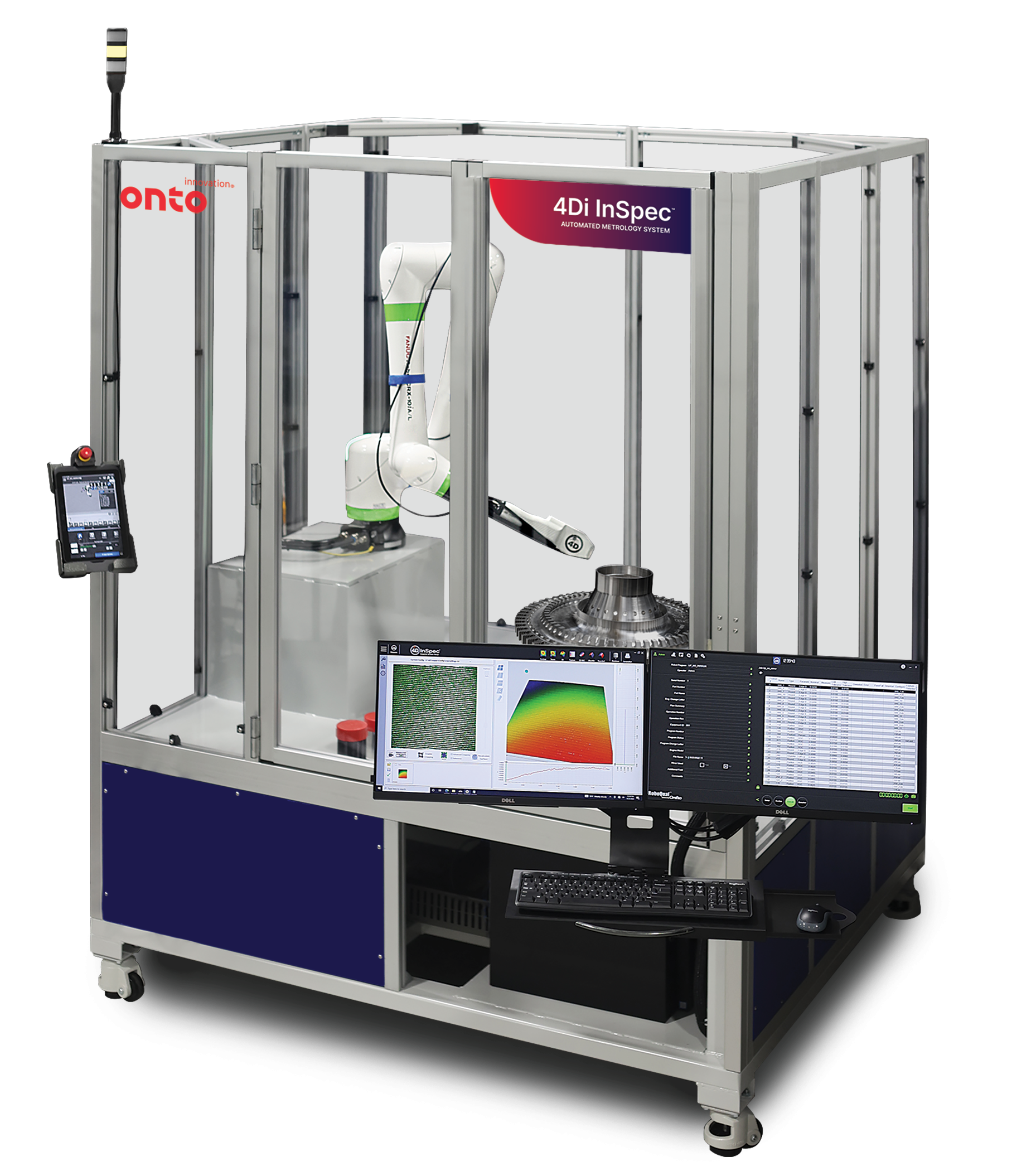

Automated 4D InSpec measurements enable a high-throughput, high-resolution defect and feature inspection solution.  An automated system can measure dozens to hundreds of edge break features, chamfers, and defects in minutes rather than days, vastly improving throughput and driving down inspection costs.

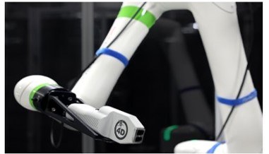

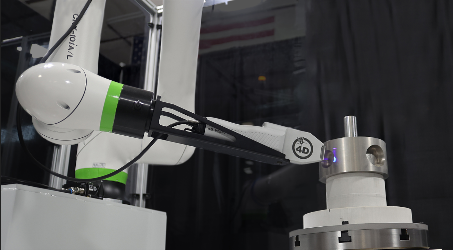

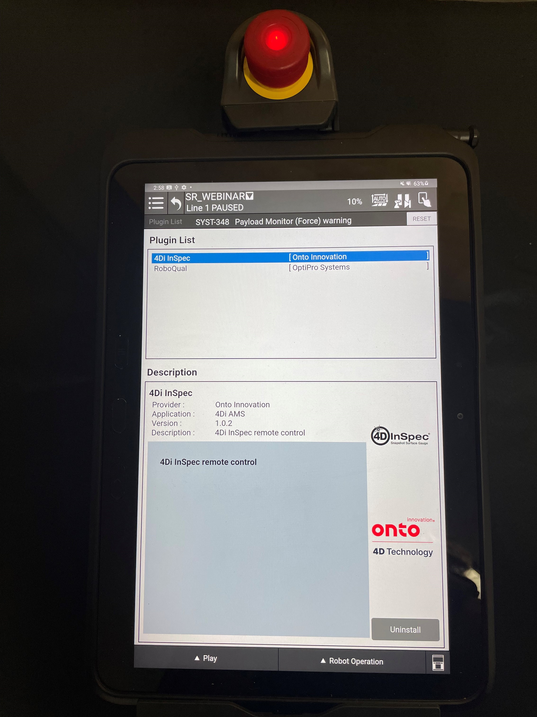

Integrate the 4D InSpec with a FANUC CRX robot easily with the 4D FANUC plugin for a fully automated 3D, optical inspection system to measure features such as chamfer, radius and edge break and defects such as pits, dings, scratches and corrosion.
