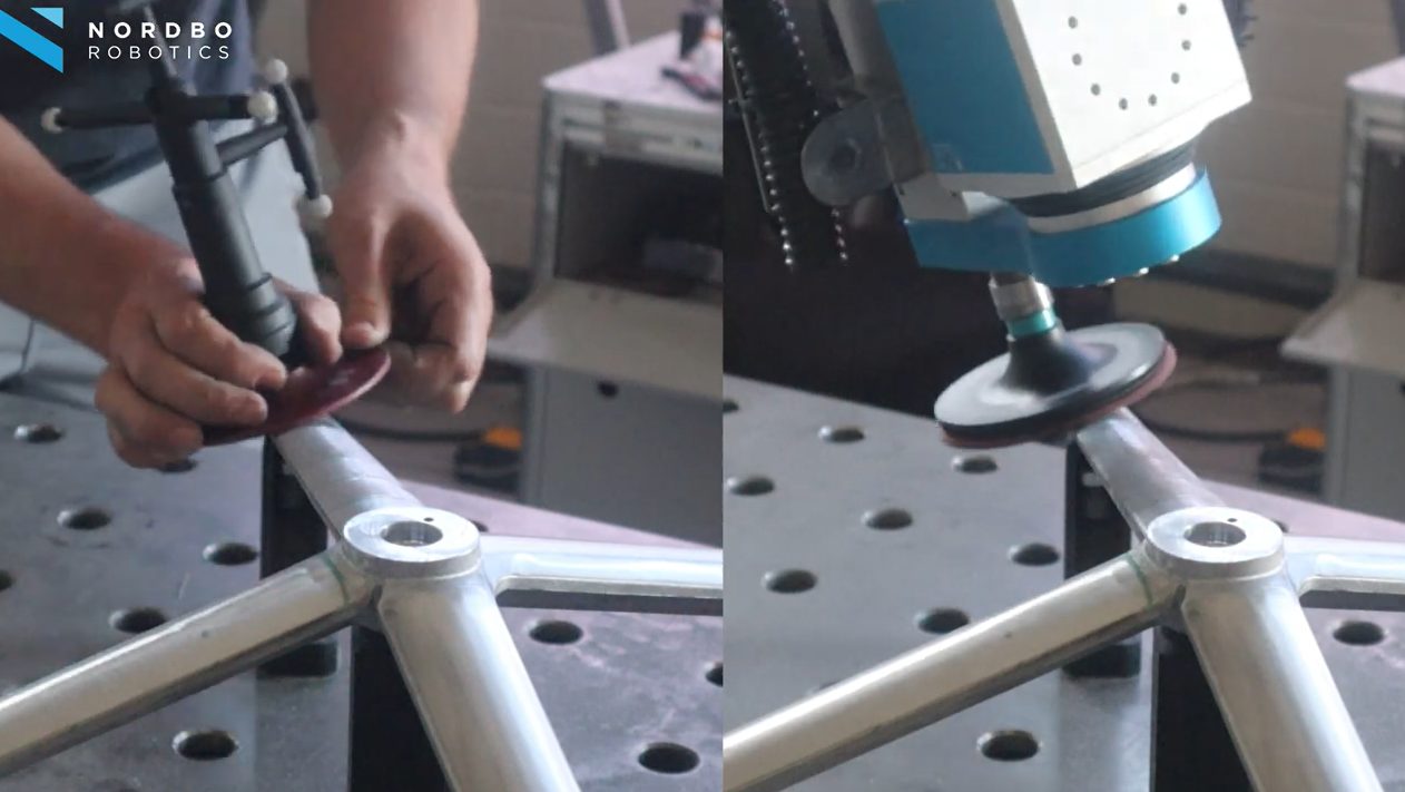

Mimic is an intuitive yet powerful software platform that, together with tracking hardware, empowers your craftsmen to automate tasks - no programming experience required. With Mimic, operators can simply record their own movements and instantly transfer them to a robot, making automation faster, easier, and more accessible than ever.

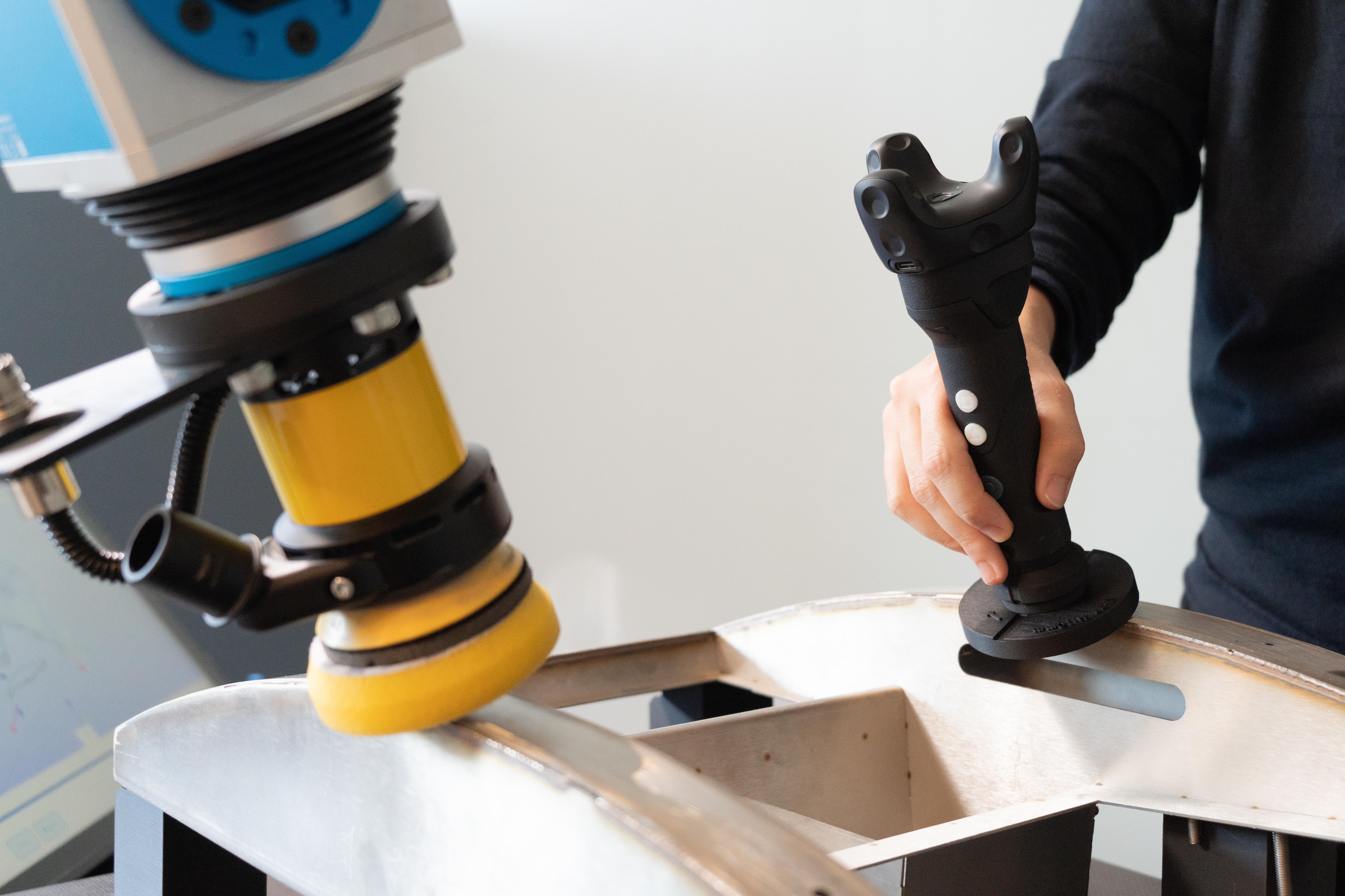

Mimic is an intuitive, user-friendly platform that empowers your skilled workers to teach robots through hands-on demonstration—no prior robotics experience required. With Mimic, operators can effortlessly record their own movements and have them replicated by robots, eliminating the need for time-consuming, expensive programming.

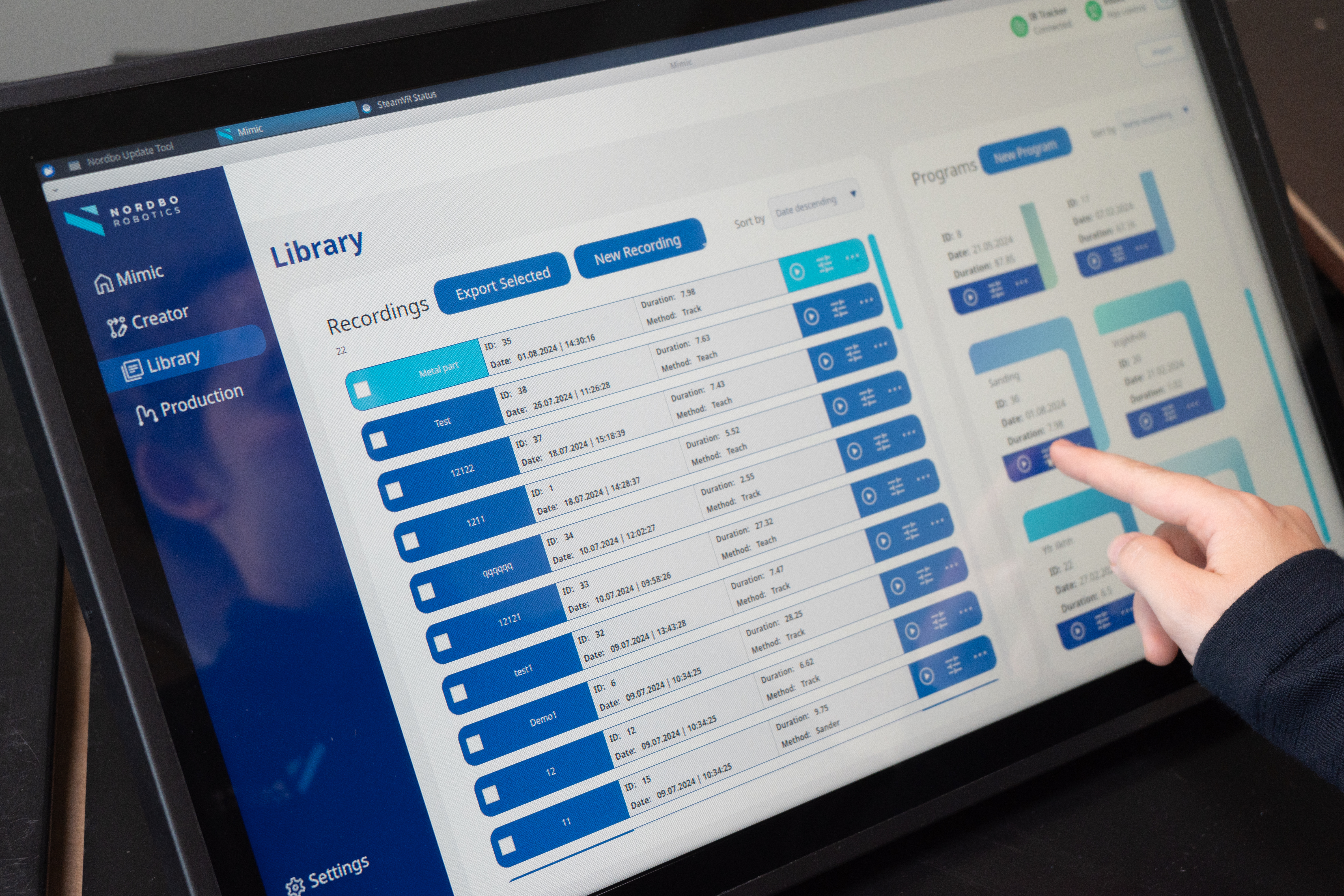

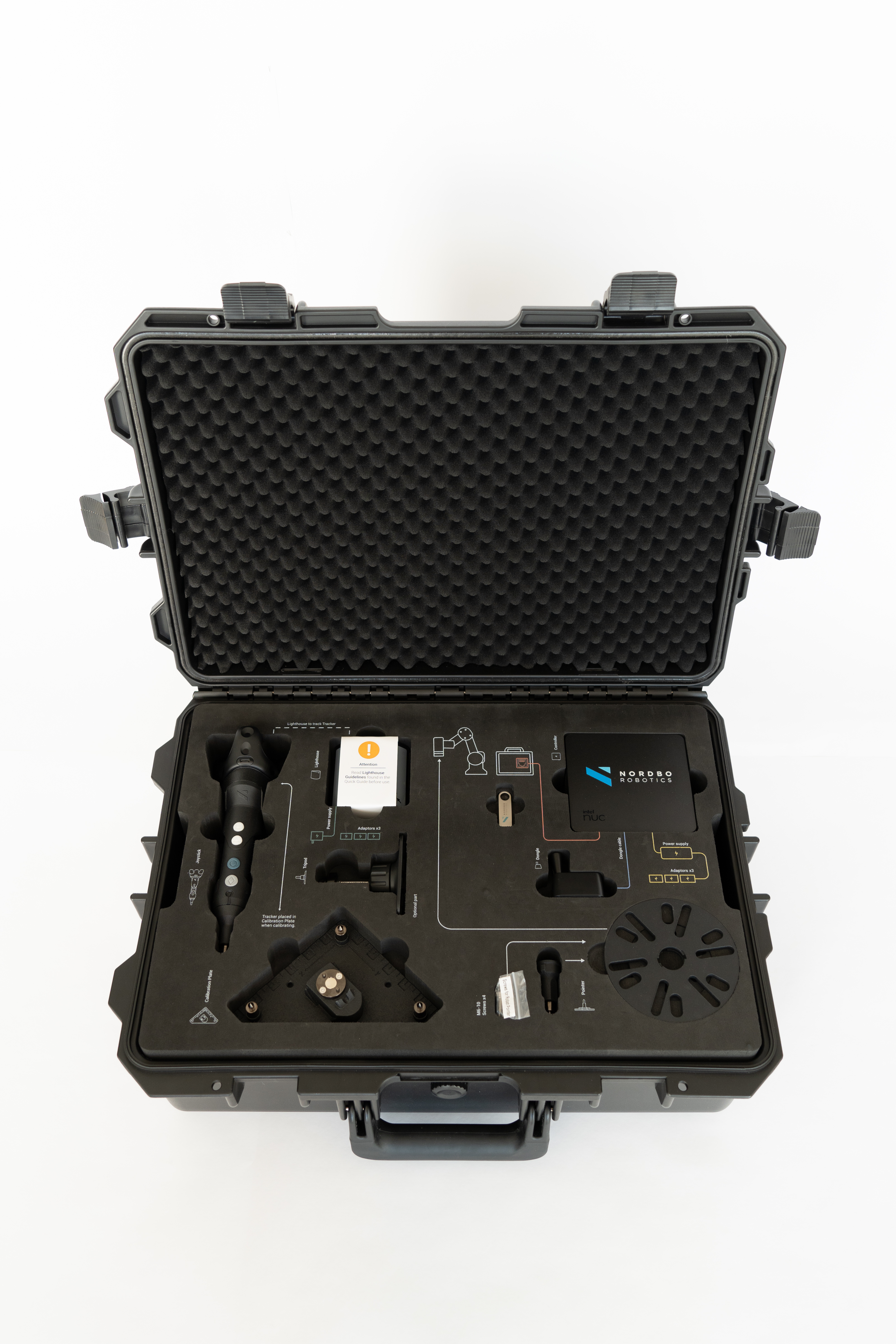

At its core, Mimic consists of a compact controller loaded with powerful software and tracking systems for demonstrating motion paths. The platform features an easy-to-use interface and integrates seamlessly with conveyors, sensors, robot I/Os, and robot routines (such as tool changes). Mimic also includes robust and quick editing functionalities, allowing users to fine-tune parameters like speed, force, I/Os, and position with ease.
Mimic excels in high-mix, low-volume environments and with complex-shaped parts. It brings industrial-grade automation to operations that need flexibility without complexity.

FANUC packages/controller required for Mimic to communicate with the robot:
  • Remote Motion Interface (R912) version 4.0 (FANUC specific)
  • Socket Messaging (R648)
  • KAREL (R632) package for FANUC
  • RMI requires a controller of type R-30iB Plus (hardware) and the software version on the controller must be V9.30P/31 or newer
