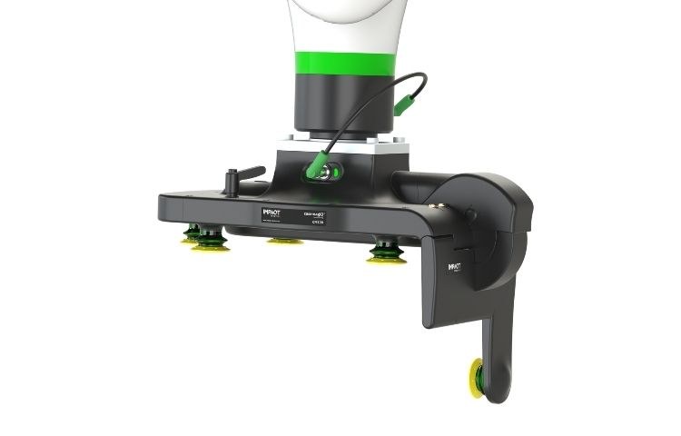

Simplify end-of-line palletizing with Impaqt Robotics.cobotizur is a palletizing platform designed to make end-of-line palletizing easier to deploy, operate, and scale. The platform is available in two series: cobotizur CT with a telescopic column for low-payload palletizing applications that need adjustable working height, and cobotizur CF with a fixed column for applications that require higher payload capacity, maximum reach, and taller pallet builds.Both series follow the same platform approach, bringing together the robot setup, palletizing hardware, vacuum gripping, controls, HMI, cable management, accessories, and software in one system. Instead of treating every installation as a new custom build, cobotizur reduces the repeated engineering normally required from project to project while allowing the final setup to be configured around the product, pallet pattern, layout, and production requirements.

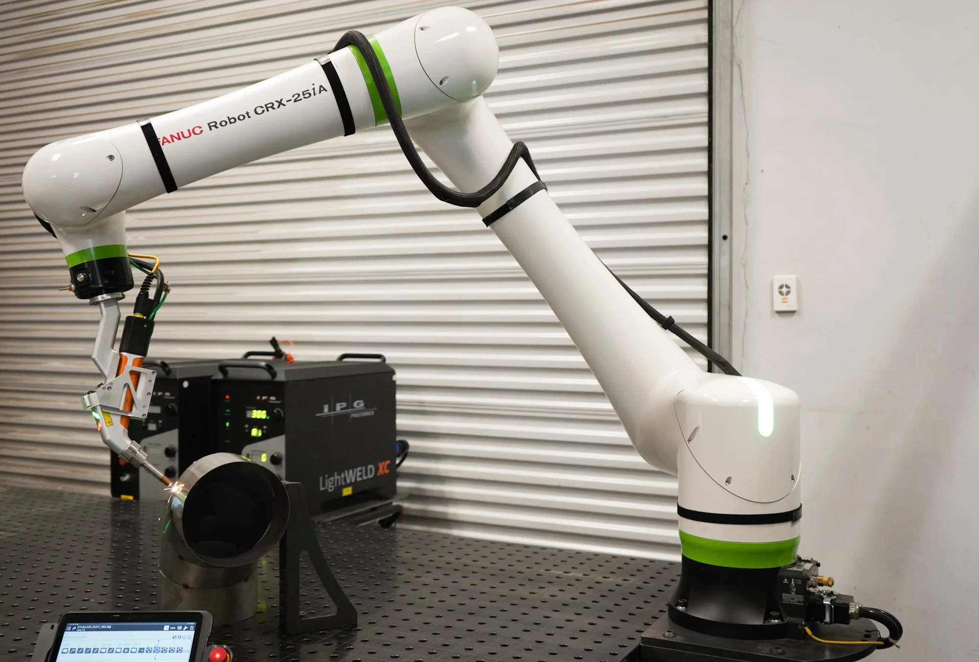

Serra Laser
LightBOT Co Robot System
The LightBOT Co-Robot System automates laser welding and cleaning, enhancing precision and productivity with its user-friendly design and adaptable capabilities.

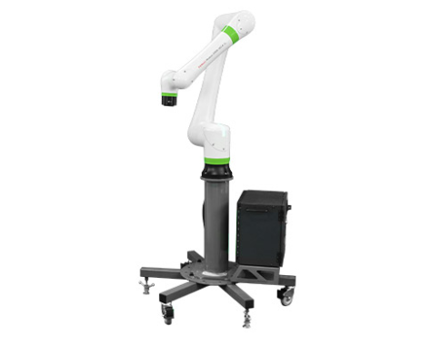

CRX Palletizer Maverick
Applied Manufacturing Technologies

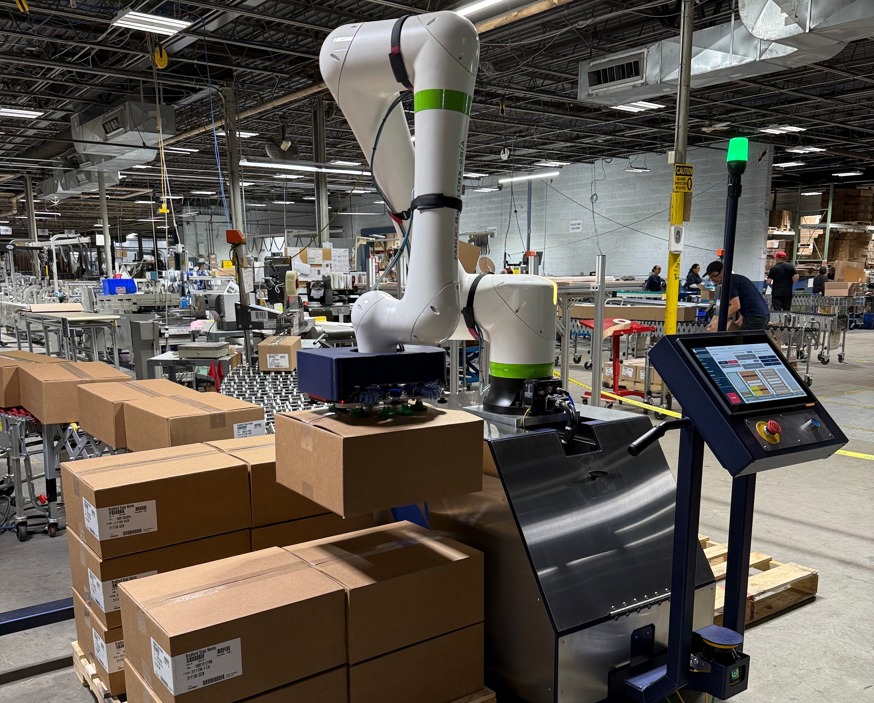

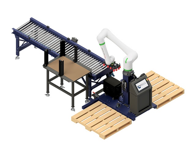

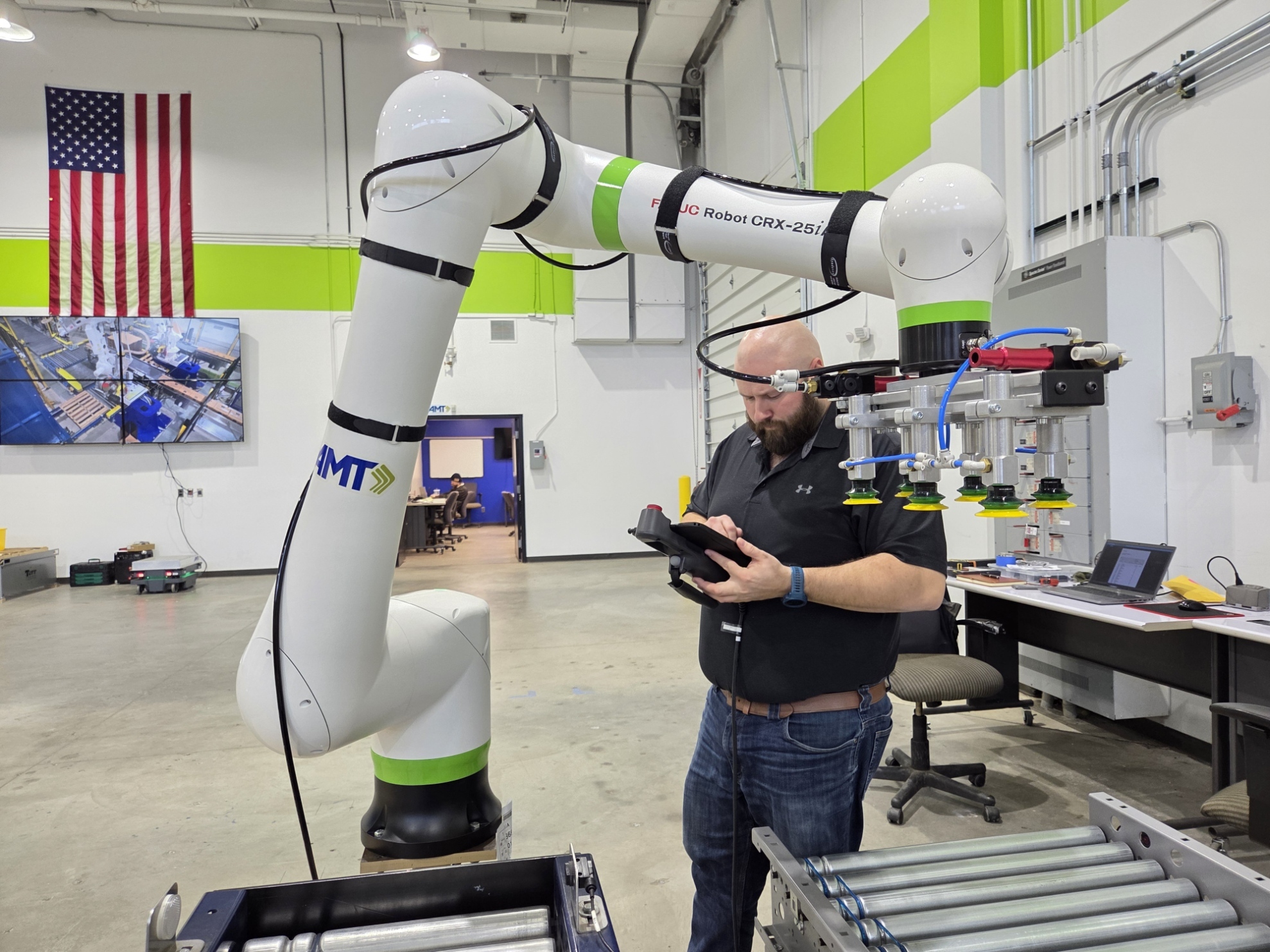

CRX-Palletizer - MAVERICK
60" Pallet HeightsUp to 12 Picks/Min**25 KG CapacityPortableinIntuitive Interface
